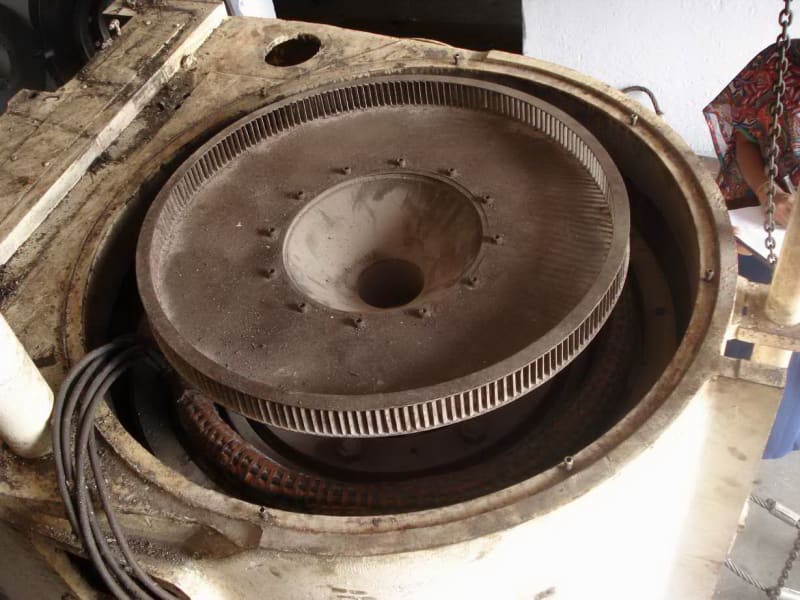

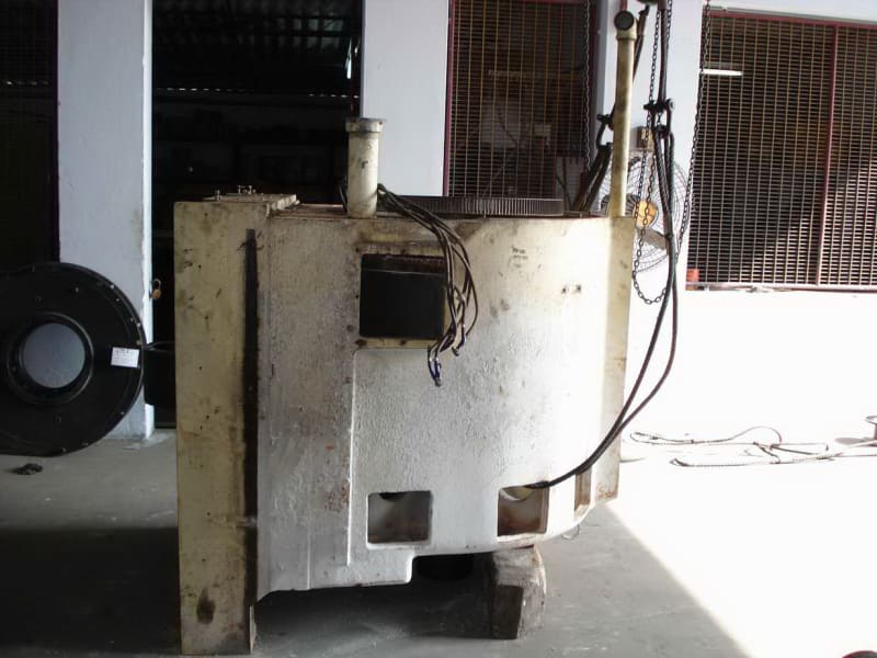

Keith - This is one of the 12 weird monsters (called Blanchards) which we rewound and refurbished over a period of 4 years. Don't be fooled by the size. It's still a low HP, low speed machine from 50's made by GE (when GE was actually being GE).
The client had scoured the scrap markets around US of A and mopped up all the available ones.
Then two years later, they come to us and ask "guyz, we want more of these but none is left to buy, can you make them for us?"
Yes, we were delighted, why do you ask?
Muthu
Muthu I see no size issues with the picture.
HAh! Blanchards! I work at a place that has seven of them. The 50HP ones are enormous and I always look at those motors that are about the size of a 55 gallon drum and wonder "what am I going to do when one of those fissile.
