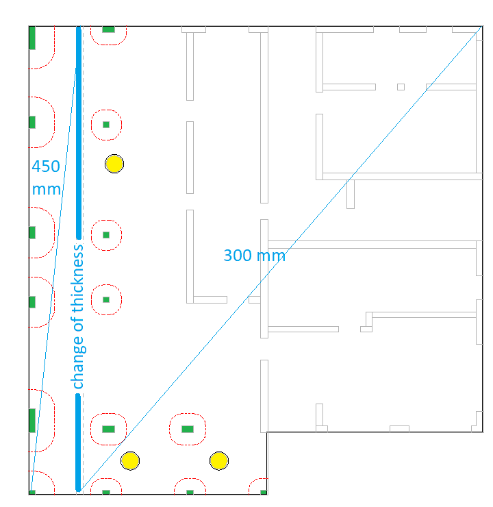

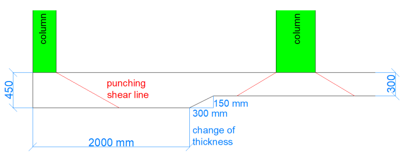

Hello!
I'm dealing with a concrete structure (walls and RC frames). Foudation slab is 300 mm. Since I have some columns with pretty large forces at the edge of the slab (punching shear) I have been thinking to make RC slab thicker (450 mm)in area bellow columns.
What is the proper way to change thickness?
Is it ok to change the thickness over a short distance (as shown in attached image) or should this distance be longer?
I havent done this before so I hope for some sugestions.
Thanks, regards
Green - columns,
Red - punching shear lines,
Yellow - opening in the slab
