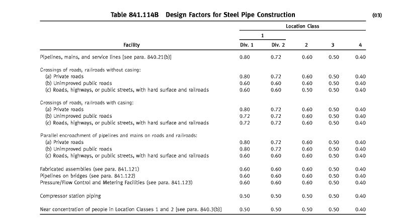

- ASME CODE FOR PRESSURE PIPING, B31.4 is for PIPELINE TRANSPORTATION SYSTEMS FOR LIQUID HYDROCARBONS AND FOR OTHER LIQUIDS
- THE RELEVANT CODE FOR GAS DISTRIBUTION AND TRANSMISSION IS ASME B31.8 WHICH IS MORE STRINGENT,
- YOU CAN FOLLOW API RECOMMENDED PRACTICE 1102 AS LONG AS YOU COMPLY WİTH THE REQUIREMENTS OF B31.8
- DF VARIES WITH LOCATION CLASS ( CROSSING AT CROWDED CITY CENTER , SUBURBAN, RURAL ...) PLS LOOK 840.22
- PLS LOOK 841.145 ADDITIONAL UNDERGROUND PIPE PROTECTION

As noted above you seem to be using the wrong design code. Gas pipelines fall under B 31.8 as HTURKAK and others say

many thanks to everyone! thanks for pointing out that I should use 31.8 instead of 31.4...that's very helpful!! For liquid pipeline, effective stress design factor can be 0.9. I still don't find the factor for gas pipeline though, but it will definetely smaller than 0.9 to my understanding. My calculation only satisfy 0.85Sy,so now I'm trying to show my boss that it's unsafe to have an uncased gas pipe under the railroad. We also have another section when the uncased gas pipe is crossing the roadway, similarly, the total effective stress won't pass.

Total effective stress limit is 0.9 SMYS for either gas or liquid pipelines.
The area class design factors apply to Barlow calculation and to "total longitudinal stress", each of which do not address "total effective stress" as does API RP 1102. The area class design factors 0.4, 0.5, 0.6, 0.72, 0.8, for gas pipelines and 0.72 for oil pipelines do not apply to total effective stress based on the Von Mises formula. B31.4 and B31.8 do not use Von Mises formula. They are a Tresca stress calculations, so the failure criteria is different when using the Von Mises total effective stress formula in API RP 1102, hence that is = 0.9 SMYS.
You can see this implementation on page 34 of ADNOC's pipeline specification here discussing crossing calculations. It is identical to the Enbridge calculation I posted above for their oil pipeline (it was for Line 3 Replacement project). API 1102 applies to both oil and gas pipelines, so the same DF of 0.9, or sometimes even set as high as 0.95, can be used for either type of pipeline, oil, or gas.
Furthermore, B31.8 2012 mentions the 0.9 factor specifically.
B31.8 combined stress limits are given in paragraaph 833.4

Miaaa1101 is using ASME B31.4. API 1102 directs users to use the DF from the design code when evaluating for allowable stresses. Table 403.3.1-1 of ASME 31.4 provides allowable stress for effective stress as 0.9SY.
