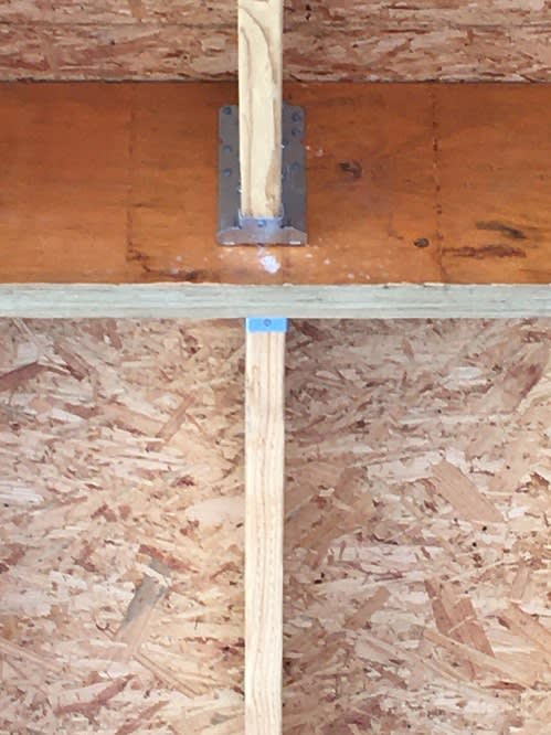

This is a bit of an odd question.
I've got rafters that will be face mounted to a supporting ridge beam. I'm using engineered wood for the ridge beam, which has allowed a reduction in the overall width of the member.
The hanger hardware I'm looking to specify uses 16d nails. I'm concerted about the nails colliding when rafters are installed each side. I don't want to have to offset one side.
What's the solution for this?
I've never actually seen this be an issue in practice.
Do you need full hanger capacity? If not, there's often reduction factors that can account for using shorter nails. Or screws.
Not sure what product you are using but my Simpson LRU series use a short nail or screw and the attachment points are offset on the sides of the rafter to avoid this problem.
Oh, that LRUZ is going to be perfect. Thank you!
