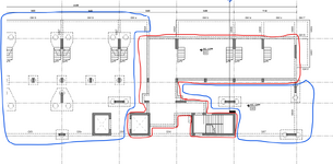

Raft on piles
M.hagag
Jun 24, 2025
1
Hi all, I have a suspended raft on piles which is supported on some of its edges by basement walls, I noticed some piles reactions are way less than columns reactions they are supporting, my assumption is that due to the presence of the rigid retaining wall, anyone faced a similar issue , please refer to attachment for more detail1750802219052.png
