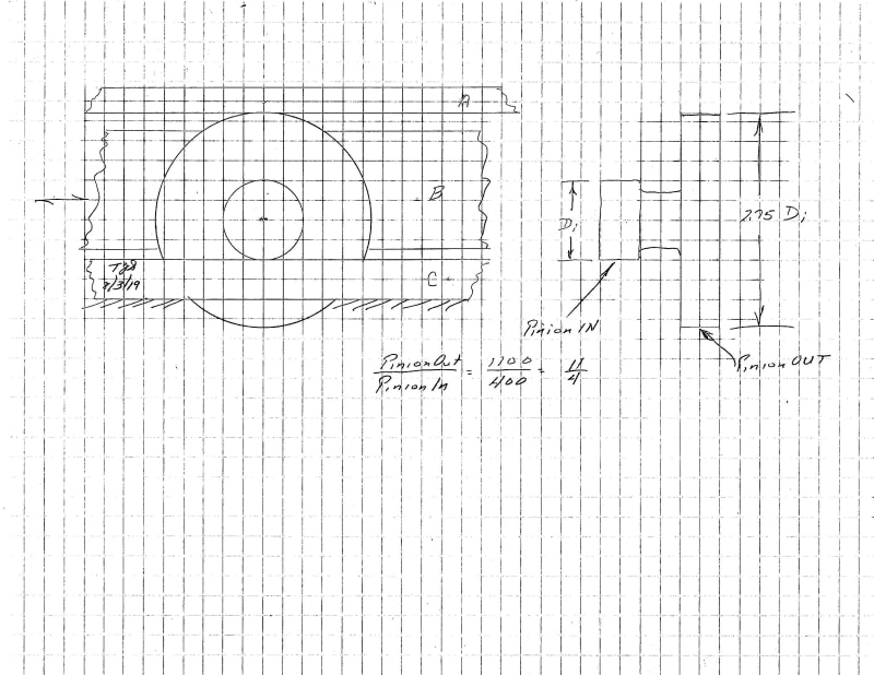

rjsutton, here is one sketch.

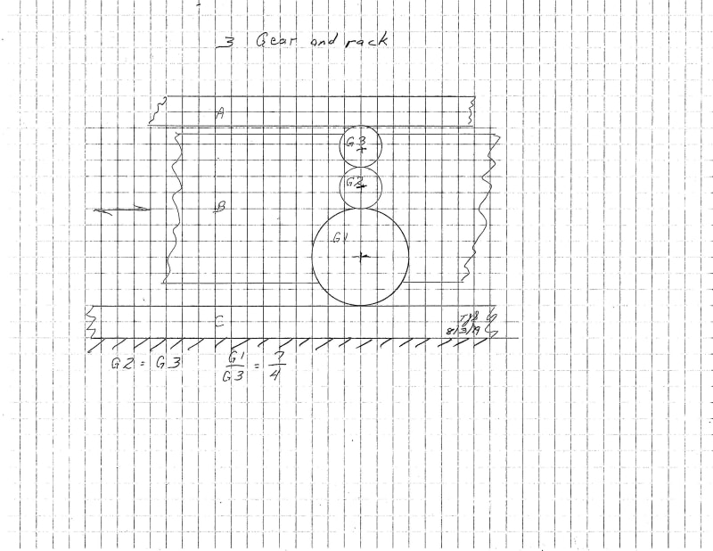

and another:

I don't think so. The pitch circumference of the larger gear must move its rack 1100mm relative to C.
Edit: irstuff, rethinking this I have to agree. A moves 400 with B and another 400 due to the rack movement for a total of 800 relative to C. A needs another 300 displacement. So, 4+3=7 to 4.
Ted

assume the 2nd diagram is the correct gearing ?7:4
the middle gear is to reverse the rotation direction only
Richard
In the second sketch the three gears are mounted on B. B moves the gear train. Rack C drives the gear it engages causing the gear chain to transmit drive to the rack attached to A. So C is the input and A is the output.
Change the first sketch by making the ratio 7:4 instead of 11:4 while retaining the idea of a compound pinion.
