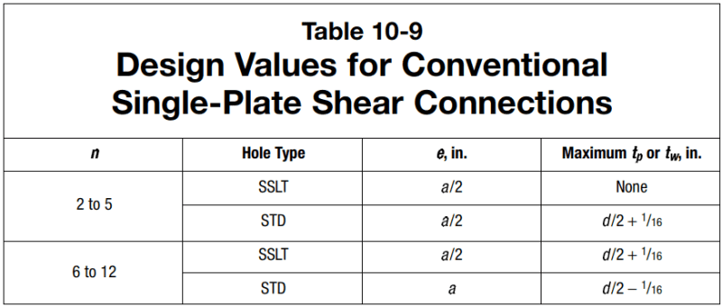

Standard holes must be checked for a larger eccentricity than short-slotted holes per the Steel Construction Manual, Table 10-9, when there's 6 to 12 bolts. They also require a thinner plate or beam web to meet the ductility check, regardless of the number of bolts, so it is possible that using standard holes will be a structural issue too.

Guys, thanks for the info. received so far, Yes, I have to provide SSL in plate not beam, refer to below snap for table 10-9 suggest to use min plate thick when bolt numbers lie between 6 to 12, From all these comments, we can provide either STD or SSLT holes depend on bolt number,dia and eccentricity, right?

Please clarify the question. Table 10-9 supports standard and short slots. But if the EOR said slots, then slots are mandatory.

Table 10-9 provides some advantages for short slots, but I don't think that's why slots are typically chosen.
