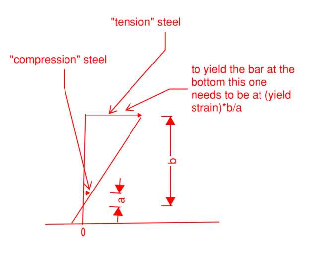

I'm evaluating an existing condition, with a very lightly reinforced 2-way slab system.
We were trying to eek out capacity by considering compression steel at a support, but noticed that the neutral axis was very small. The "compression" steel was actually in tension at the ultimate limit state. In fact, in many sections we evaluated the bottom steel was even yielding in tension!
Yes, the bottom bar is fully anchored and developed at face of supports. However, I have some heartburn about developing yield (in tension) from the other side of the critical section, an issue that isn't present for the top bars (as sketched in the attached).
Consider the moment diagram of a fixed-fixed span. The negative moment decreases quadratically from peak negative moment at the face of support. The point at which the cracking moment is exceeded is qualitatively not that far away from the face of support. So there is (qualitatively) not much length to develop the tension force in the bar.
Thoughts? Is there something we're missing? (such as considering rebar slip?).
Cross section properties for those who like to check math:
180" width of 8" slab, 6ksi concrete
10#5 top bars (d=6.875")
15#5 bottom bars (d'=1.125")
 https://files.engineering.com/getfile.aspx?folder=3c9dfd20-9b30-4c9e-ba55-a8f2c68b7bae&file=Section_Mechanics.png

TLHS “ You're also going to have really big crack widths and your far face bars are going to have to strain a long way past yield to yield your compression face bars. Your tension face will be at several times the yield strain, probably.”
I would actually expect the opposite if the “compression” side bars are actually in tension then to satisfy section equilibrium the neutral axis would be lower and actually reduce the extreme tension strain and you’d reach the anticipated capacity at less curvature. So you want to make sure the far face bars yield so the section remains tension controlled.

Celt, in normal reinforcing patterns that would be true. In this case the bars are so far apart that the effects of the bar distances will be much more significant than the shifting of the neutral axis, unless I'm misunderstanding the mechanics of this admittidly unusual situation.
If you're just yielding the one layer of bar then your tension face strain is basically just the yield strain of the rebar. Now you need to yield both, though, so your bar just slightly past the compression zone has to yield. To maintain strain compatibility your far bar now needs to go well past yield strain and your crack sizes open way up.

This is surely an odd case especially so since there are more “compression” bars than top face bars. My quick napkin calc the extreme tension steel strain gets reduced by 1/3ish if considering the near face bars as tension reinf.
et = 0.028 with bottom face bars in tension (a=0.502 in)
et = 0.074 w/o consideration of the bottom bars (a=0.203 in)
a = whitney block depth
Yes, this is an odd case. More bottom than top bars over support. And before the calculations get too precise, consider that bars are often not placed at the exact depth assumed.
Fair enough, Celt. I didn't do the math and it looks like it may be more strained as a starting point that I figured. In that case the effects I'm talking about potentially don't become significant.
If you reduce down to a per foot basis the additional capacity works out to less than 1 ft-kip/ft and it barely satisfies minimum flexural steel requirements.

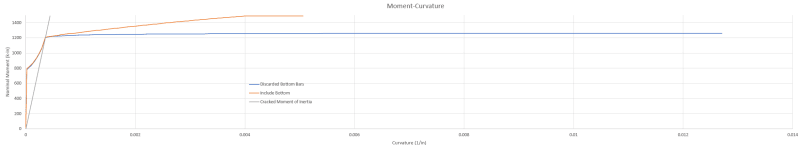

With flexural sections containing multiple layers of tension reinforcement, the portion of the moment-curvature diagram isn't so flat after the outermost layer yields. It only becomes flat after the last layer yields. However, I would say either case generally has ductile behavior as it is "flat" enough relative to elastic behavior. Plots is based on excel spreadsheet that numerically iterates each data point to find neutral axis.
After generating this plot, I realize moment redistribution on the demand side is potentially non-conservative if we are counting on the higher capacity from compression steel in tension - there is relatively reduced amount of rotation deformation after the bottom bars yield, so that is something we'd need to potentially consider.
I didn't realize the picture would end up so compressed.
blue plot is the moment-curvature diagram when ignoring bottom bars.
orange plot is moment-curvature diagram when considering bottom bars. They diverge after the top bars reach yield. The orange plot increases in nominal moment... until after sufficient deformation the second layer (bottom rebar) yields.
I also plotted a gray line which is if you were to ignore elastic section properties and cracking/tension stiffeneing (I gross and I effective) and instead just consider I cracked.
