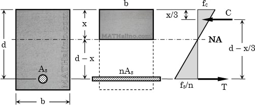

i would like other engineers' thoughts on doing a quick beam calculation in this manner
if i design a beam with similar top and bottom steel, i want to just calculate 0.9*As*Fy*d as a max beam moment.
of course i'll check for min and max steel in the concrete section. On every section i checked, the concrete compressive capacity has been higher than the steel.
I want to do this without having to rely on software or complicated hand calcs.
I think this would be a very conservative design, unless i am missing something here.
 https://files.engineering.com/getfile.aspx?folder=132aafad-f9ab-4664-8f3b-5adc5af94911&file=typical_beam.png
Once-upon-a-time, long, long, ago (pre-1963)... a method similar to your description called Working Stress Design was THE way reinforced concrete was designed. WSD remained allowable for use until the early 21st century, as I recall.

A lot of engineers use similar equations as basic design tool. Most of the time people use a proportion of effective depth as their lever arm (eg 0.85d), as opposed to the distance between top and bottom steel.
The change to Ultimate design in concrete wasn't a life-safety motivated change. It limped along in the appendix for a fair while as well. The two approaches (if you ask me) don't produce dramatically different results, similar to ASD and LRFD, but for whatever reason, limit states design in concrete went though more smoothly. I'd say the LRFD version of concrete is around 1956 version (as an Appendix) when it first shows up, but I may be wrong. So they did it about 20-30 years before Steel.
As a side note, the 1971 is where it's in the main code, and that's also when static moments for slab design actually matches reality.
ACI 318-63 contains both Working Stress Design (WSD) and Ultimate Strength Design (USD). Either method was permitted by code, but USD was preferred by most engineers.

If I remember correctly from my college concrete classes (40 years ago!), the switch to ultimate strength design was made because the approach is more consistent. You factor up loads, and you reduce strength. Using working stresses for all situations does not yield consistent results.
It is advantageous once in awhile, such as when your load is mostly dead load and you get to use a smaller load factor.

uglukinpjs - WSD could result in designs without enough shear reinforcement... leading to problems that were difficult to repair. Many vintage highway bridges had shear cracking of their cast-in-place beams (deck girders) as they aged and had to be replaced.
We always did limit states design, starting in '65... and other than for historic reasons never really did any working stress design. For small percentages of reinforcing we used to use As = Mu 12 /(phi .9*d fy) as a quick estimate.
