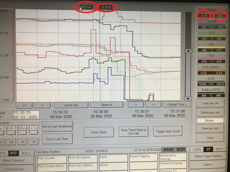

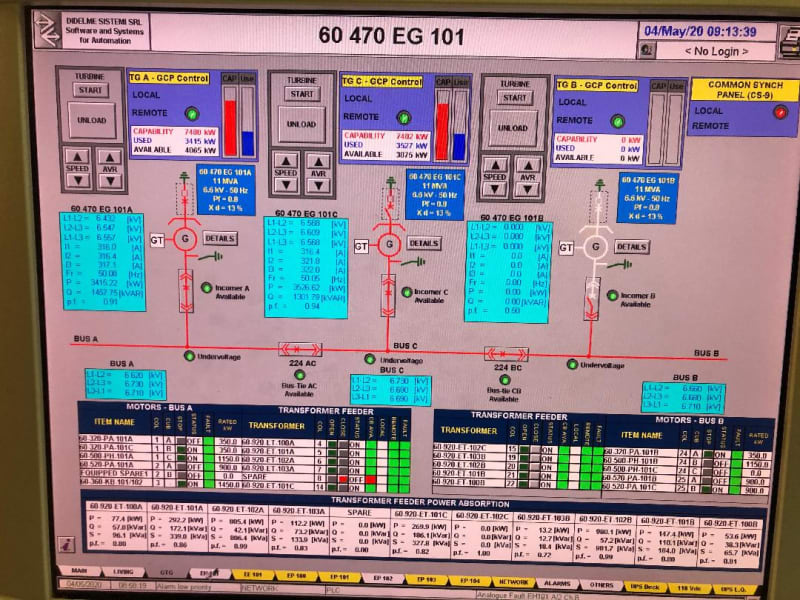

it is s set of three 11000KVA 6.6kv alomost 8KW ,here you will fine a screenshot of the ECS workstation .
because we have a high power heaters 2000kw that are driven by VFC the load swings by 600kw per 0.5 sec .
the turbines get a power fluctuation whit out any load new load engaged
Before shutdown unbalance occurred in power load suddenly increase in Turbine A from 3,478MW up to 5,116MW, and after decrease back to 3.478MW then increased again to 4.876MW see below photos with trends(the power load is the red line on trend):
After one second the power suddenly decreases in Turbine B from 3,272MW up to 2,316MW, to compensate load sharing see below photos with trends:
