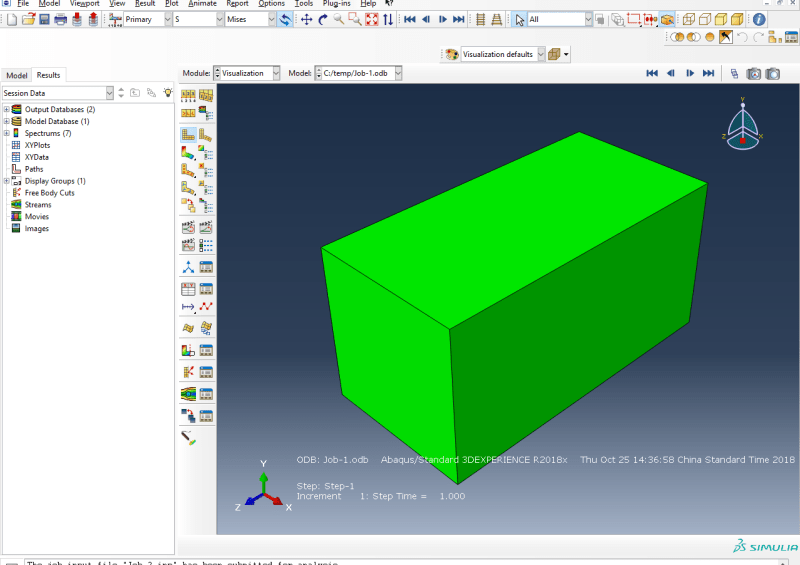

Because I just start to learn about Abaqus for my project.
I learn how to model a reinforced concrete column on Abaqus.
But I don't quite know how to arrange the loads and make them changing with time.

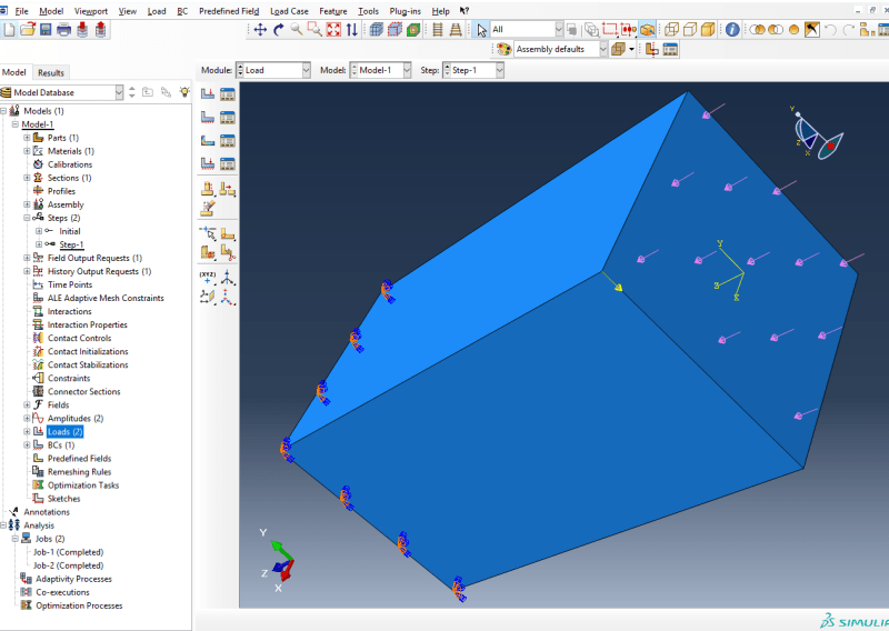

Here is my trial about setting of load:
For my axial load on tabular
For lateral forces on tabular:
Is that correct? However, I tried this setting on just a rectangular solid, it just showed Step time = 1
Since you have a pseudo time of 10 you need to set the final (pseudo) time to 10 in your Step definition.
By default it is set to 1.
Then in the Load or Interaction module go to the main menu and Tools/Amplitude/Create, and assign two curves as you show in your excel table.
Once you have that amplitude curve defined you can choose it and assign it to the loads when defining the moments and forces (under Amplitude drop list, by default it is Ramp).

What to u mean by "assign two curves as you show in your excel table." Does that mean put the excel table into Tools/Amplitude/Create>tabular ?
Thank you very much. You really help me alot
Yes, you need to enter your table values in there (just press enter to create a new row when you are on 2nd row and 2nd column, because there are only two rows in the tabular table; alternatively copy paste your values from excel into the abaqus table). In any way I am sure you will manage to do it, just try it out.
