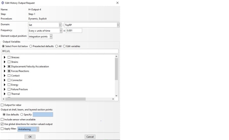

Hello,
I am running a post-buckling analysis using the explicit solver.
In the history output, I requested the top reference node's reaction force and displacement at every 0.001 sec.
My query is:

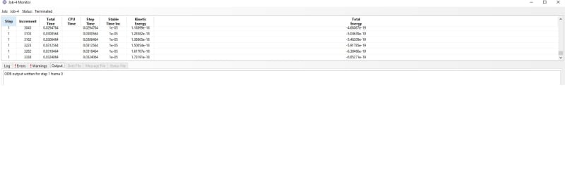

While the analysis is running, should I get the output at every 0.001 sec? Or is the output written after 1 sec?
I can see in the job monitor that the job has run up to 0.02 sec, but ODB output is written only for frame 0.
Could you please clarify?
Many thanks!
Can you share a screenshot of the window with the definition of this history output?
Thanks,
Please find the screenshot as below:
Could you please clarify? I shared the screen-shot as requested.
Many thanks!
With such a setting this history output should be written every 0.001 s and at the end of the step. However, keep in mind that this applies only to the discussed history output, not to field output, among the others. Open the odb file and plot this history output to see if it’s written with the correct frequency.
