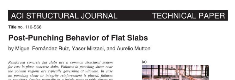

I just wanted to add that there are some articles by prof. Muttoni (et al.) that discuss mechanisms of punching shear failure so maybe more details can be found in those articles. I just skimmed them but they seem really good.
hardbutmild said:
More reinforcement = narrower crack, right?
Yup, I agree. And I don't doubt that, to some degree, additional tension reinforcement helps to improve capacity by simply doing a better job of holding stuff tightly together.
hardbutmild said:
I called it collapse reinforcement because it avoids total collapse even if punching occurs.
The jargon for this in north america is "integrity steel". I favor less jargony descriptors when I know that I'm dealing with folks from other parts of the world.
I believe that I have that if you're interested in discussing any part of it in detail.
