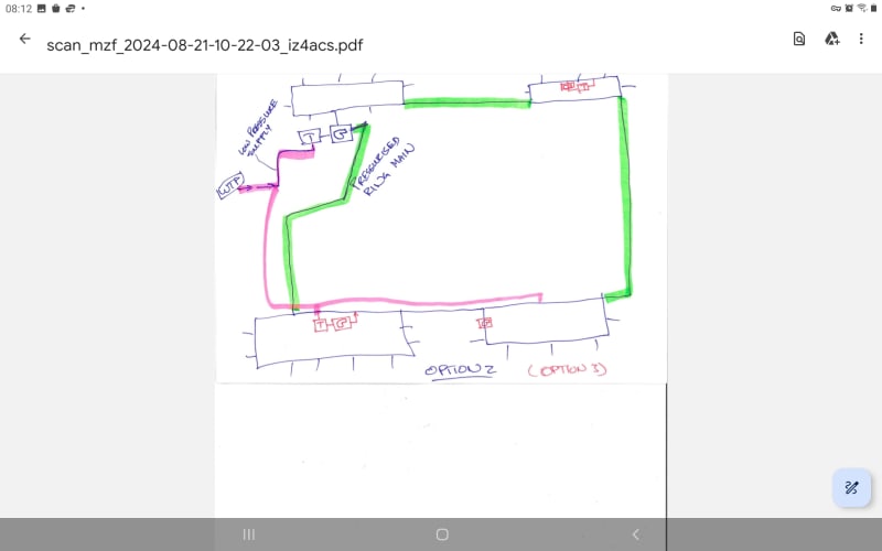

I have designed and EPAnet modelled lots of gravity water networks but am now faced with my first flat-earth water reticulation that requires booster pump(s)
The development will ultimately be made up of 4 large blocks of industrial land (no high water use) that surrounds a runway. The development is supplied by a low-pressure municipal supply. The current situation is that three of the blocks are developed with their own reservoir and pump to their internal networks. (shown in green)
We will be developing a new block that is about 130Ha and one of our requirements is to ringmain water connecting all 4 blocks. What i am unsure of is do we continue the status quo of adding a reservoir and pump for the new block or is it worthwhile upgrading one of the pumpstations to pressurise the ring main and all the internal networks in one go?
I am currently building the epanet network and i suspect that I may find that to create adequate pressure (3bar) at the furthest extent of the network may result in the pressure closest to the tank being too high which would then make sense to have 4 pumps and 4 networks.
Fire storage may become a sticking point as we would need fire volume at each network ... unless we can somehow link all the pumps for fire flow.
Just asking if it is possible to just boost the network inline? so go with Option 2 but have an inline pump boosting the pressure at each block? I cannot see this working as the pump will be sucking and pushing at the same time?
Any comments, guidance, or reference material will be greatly appreciated
[URL unfurl="true"]https://res.cloudinary.com/engineering-com/image/upload/v1724190660/tips/scan_mzf_2024-08-21-09-28-01_nvdnoa.pdf[/url]
Thinking a bit more about it we will not be able to create a ring main approach without building a complete new ring main as the existing system did not cater for it and we would be connecting off the end of the networks. I have highlighted the existing low pressure municipal supply in pink and proposed connection pipework in green.
I have shown an option 3 in having in-line pumps (and reservoirs) in each block in red

Looks reasonable. Try designing it like that and see exactly what equipment and pipe sizes you need. Do the same for other options. Then we can compare and decide what would be best. Right now you do not have enough detail to make any decisions.
Thanks, will build the network and start playing with epanet
