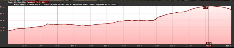

Residential building is 350m (1,200') from city water source (clean potable water only)
Elevation change is an increase of 30m (100')
Flow Rate: 10-15 GPM
Power source = Electric
Pipe: 2.5 cm (1") black poly pipe
Climate: Tropical: HI = 28.4 °C | 83.1 °F, LOW: 15.6 °C | 60.1 °F
Tank above building: 4 ton 1,056 GL) switched tank to turn off pump when full

Thank you for asking. 30m + 5m to top of tank
Head = 35m

3. The GE elevation data below for area is old. The 91m point on the chart is actually closer to 100m but you get the idea.
Private property and city roads limit the pump location. It can be placed within 30m of source or within 80m of tank.
At what point along the run should the pump be placed?
