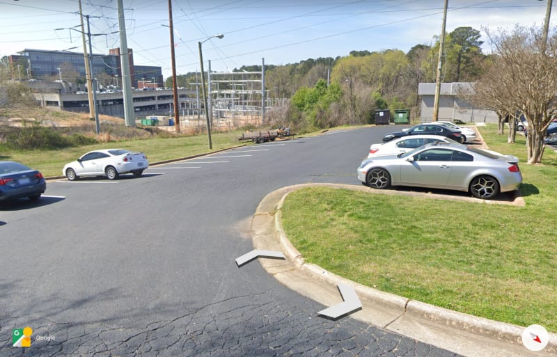

The station isn’t really that old, if I’m not mistaken it’s still under construction.
Look at the video, the old trailer in this picture is in the video also.
