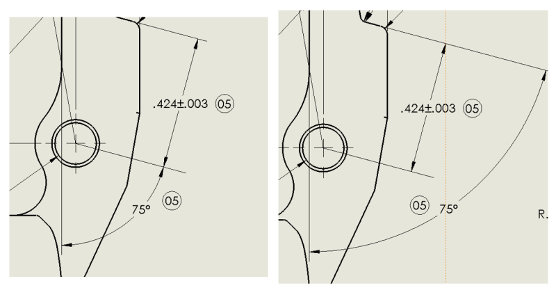

I have always been taught that if the angle on a drawing would make the view look messy that you can attach the angle to the linear dimension. I cannot find any literature in the GE, ASME or Saab drafting standards books that explicitly tell me the correct form. Can someone tell me if the left version is legal and if so, is there any literature that explicitly represents this?
The one on the left measures literally nothing. So, the one on the right, I guess.
Both are correct, though the first example makes for a cleaner drawing.
"Know the rules well, so you can break them effectively."
-Dalai Lama XIV
It is this sort of issue that Feature Control Frames were invented - to specify the exact basis from which variations are to be inspected.
However, since the expectation is that a linear dimension with two extension lines represents an exact, perfect, and unvarying intention of parallel lines, then in any Euclidean geometry course they are exactly the same.

martinwilson,
TheTick is correct. An angle measurement must be made from a flat surface, preferably a datum feature.
