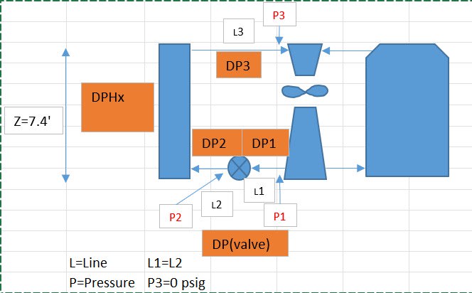

Thanks for the response, this is special design, the function of this agitator is moving molten salt between reactor jacket and salt cooler (a heat exchanger), I need to know how much flow gets into the heat exchanger. I have information of impeller size and electromotor power and RPM.

Motor power:250 hp
Impeller RPM: 494.4
Impeller type: Propeller 4 blade
Impeller diameter: 32 inch
I need to know P1?
You won't be able to estimate P1 reliably without more data. You'll need the diameter or cross section of where the impeller appears to be within, the pipe sizes of the two outlets from that area, the viscosity (and possibly the density) of your liquid, the pitch angle and blade dimensions (not just overall impeller diameter) of your 4 blades.

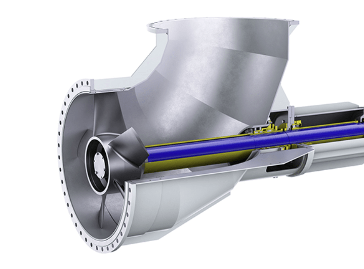

Based on this and the sketch you provided (is the twin-prop blade thing in your sketch the "agitator"?) this sounds more like an axial flow pump. By the way your sketch is pretty much useless. There are no descriptions of what the equipment is. A PFD or P&ID would be more helpful.
Does it look something like this? If this indeed a pump, you can find the nameplate somewhere on it and contact the OEM for the information you need.

Mmmmmmmm...... EXCEL Spreadsheet PIDs !!!! .... With mysterious chunky blocks and circles and Arrows !!!
I forgot how much confusing fun these were !!!!
Even a hand drawn PID sketch would be better that what we have been presented here
Oh, one more thing .... How do we know that an "agitator" (or axial flow pump, for that matter) is the best choice to move molten salt ?
How can you have a completed PID design when you have no idea of the flow in the system ????

your diagram makes no real sense as it is not clear at all where this propeller is in the system.
The pressure P is not set by the impellor, but by the downstream system and its pressure drops and friction etc.
All the agitator does is create flow. How much pressure you get is dependant on how much that velocity is impeded and turns into potential energy.
That is quite a healthy sized motor but I don't think there is any way you can calculate pressure.
Maybe a picture would do it justice. Plus, I've never seen one of those.
