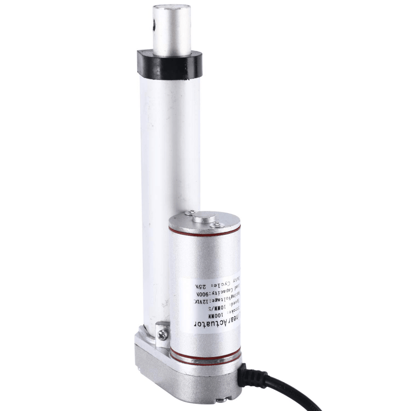

It looks like you are using the crank arms to develop linear motion.
Why don't you consider linear actuators.
Look for actuators with the travel that you want.
they have end of stroke internal limit switches.

Linear actuators with rotary encoders are out of my budget. I would definitely use them if I can afford them though.
