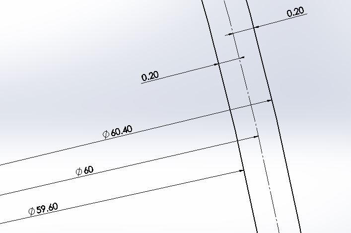

Hi guys,
See attached picture.
I am looking for how profile tolerance application differs from a feature of size to a single surface ?
If i looked at the attached sketch I always assumed, whilst the part was constrained with datum features A + B + C we would have a theoretical Ø60 cylinder.
The tolerance band would be 0.4 total . 0.2mm per side
Could anyone give me some guidance on this.
Ross
Ø60 with 0.4 profile is:
60+0.2+0.2 = 60.4(2 sides of 0.2) for the outer boundary
60-0.2-0.2 = 59.6(2 sides of 0.2) for the inner boundary
The difference between feature of size (at least regular feature of size) is that in the case of the profile perfect form at MMC and perfect form at LMC are applicable, but in the case of regular feature of size only perfect form at MMC is enforced.
The profile tolerance in the given example controls all geometric characteristics of the hole: size, form, orientation and location.
If this was changed to directly toleranced diameter dimension and position tolerance, size and form would be controlled by the diameter callout, but orientation and location would be controlled by the position tolerance.
I get what the document is trying to say, but they probably could have said it a little better than just "it is really the radius which has the profile tolerance" or shown a better picture.
Determination of the tolerance zone for a profile tolerance applied to a feature whose true profile is fully defined with basic geometry is no different if it is planar or otherwise. Its a 0.4 wide tolerance zone equally disposed on either side of the true profile - 0.2 on either side. Its just that when you evaluate it diametrically you get the calculations that greenimi shows. Just a quick snapshot to put this as a picture.
