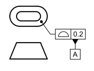

does anyone have idea or references how to profile tolerance a complex trimmed edge on say a vac formed part? I don't really see any good examples in the standard to other places. Would it make sense to just point to the trimmed edge with a 'ALL OVER' profile tolerance with a note below that states "trimmed edge". using "all around" wouldn't work to me as it is controlled only in the view its shown in and a trimmed edge would go all around in 3d.
 https://files.engineering.com/getfile.aspx?folder=a48fcf2e-7932-4edf-b9cb-17b5e0eec599&file=vac-form-sample.JPG

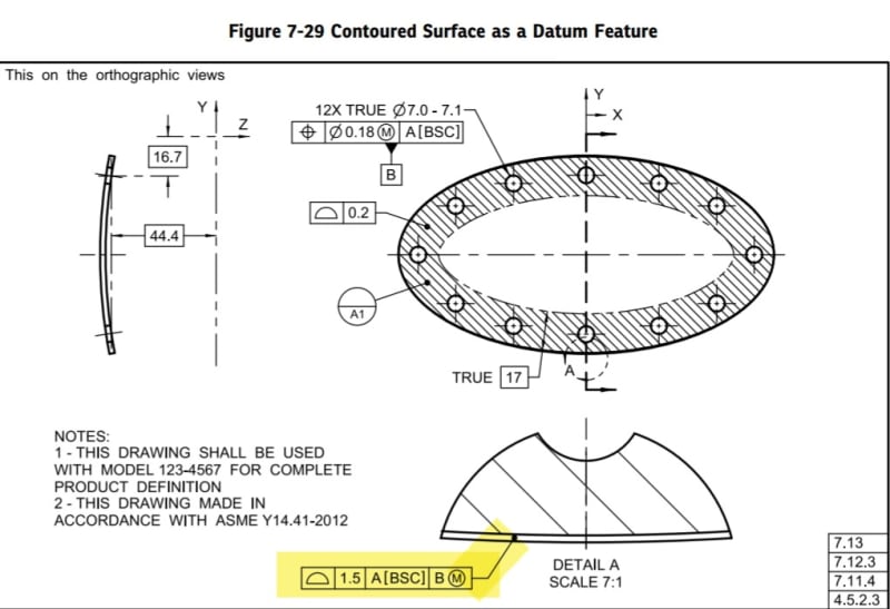

I have encountered all of the types of datums listed, except "line". Didn't find an example in the standard either. Perhaps someone on this forum can help - what is a datum line? What is the corresponding datum feature and datum feature simulator from which it is derived?
Interesting to note: according to the quote you provided, "line" wasn't included in the 1994 or earlier versions. I wonder what it was added for, especially since no examples were provided.
I hope it is not too late to ask - does anybody else share my conclusion or can confirm that the "line" mentioned in the definition of the datum concept is the "line in plane" as presented in this figure?
It wasn't clear what a Y14.5 datum line was then; nothing in the standard changed since. Who am I to argue the obvious conclusion that it wasn't described in Y14.5 by a faithful student - lack of definition is a problem that was not resolved. No one confirmed.
Mind that there is extensive theoretical research on datum lines, but the standard writers failed to include it.
The most likely source for Y14.5 is copy/paste from ISO, which does support datum lines.

ISO uses lines. Y14.5 does not. You can find examples in ISO - they are not haphazard as Y14.5 is.
"4.1 Datum being a straight line or a plane" per ISO 5459-1981.
The 2011 version is even more extensive.
