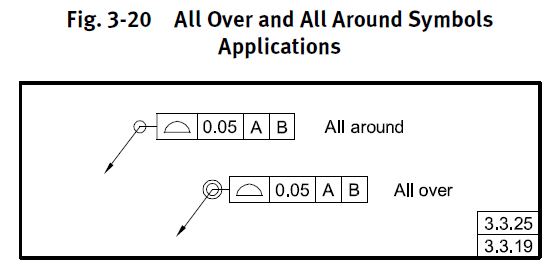

I plan on using profile on the cut surfaces of sheet metal parts. Does the all around for the profile apply across the bends, or do I need to specify multiple profiles going from A<-->B, C<-->D, etc. where each call-out goes from bend to bend?
If I go from bend to bend, I would create a primary datum for each call-out that would correspond to the applicable plane that would have been the same plane as if it was the flat pattern.
Hope that makes sense, and thanks in advance.
To go "around the bend" use "all over" rather than "all around":
I don't know if every CAD system has it, but there is also a symbol for "All Over" you can use instead of the words.

Maybe I have not explained what I am trying to call out and define. I am trying to determine if the callout in the picture I included would be correct in defining the cut path of the sheet metal part. If the view and callout were in the flat pattern it would work, but am wanting to know if the defined profile of the cut path would still apply after forming, or if each section of the path (2 horizontal, one vertical) would need to be defined separately. Of course the picture is not fully defined for bend tolerance, radii, etc. I am concentrating my question on how defining the cutter path definition call out changes (or does not need to change) as it goes from flat to formed.
Thank you.
 https://files.engineering.com/getfile.aspx?folder=2e99ed7d-85ff-49c4-829c-983629ae41bb&file=Sheet_Metal_Profile.jpg

If you add the all-around symbol to your leader line on your profile callout, I see no reason that it wouldn't do exactly what you want - ie: control the cut edge all the way around. This is independent of the processing method used to create the part (ie: forming/bending). That said, are you using MBD or a 2D drawing? Typically all-around is attached to a view and applies "all-around" in the view specified, but I would think the intent here is clear enough even for MBD.
Sorry about that. I meant to show the all around symbol in the picture.
The completed TDP drawings will be a hybrid that includes basic views, any +/- dimensions, GD&T, and directs the user to the cad model to query the basic dimensions.

The cut path of the sheet metal part is none of your business. Don't tell your fabricator how to do his job. You inspect the final bent part. If you allow for dimensions from sheet metal bends to have tolerances of [&pm;].015" or [&pm;]0.4mm, everything will be fine.
Sheet metal shops have asked me for my SolidWorks model so that they could flatten the part and mess with k[&nbsp;]factor. When you model sheet metal and you name features, consider the possibility that it will be outside your office in the hands of your fabricator.
JHG
Not trying to tell them how to make the part. I do not care if they uses an industrial strength paper cutter, plasma cutter, laser or waterjet, I am only defining the limits they must stay within on the finished part.
