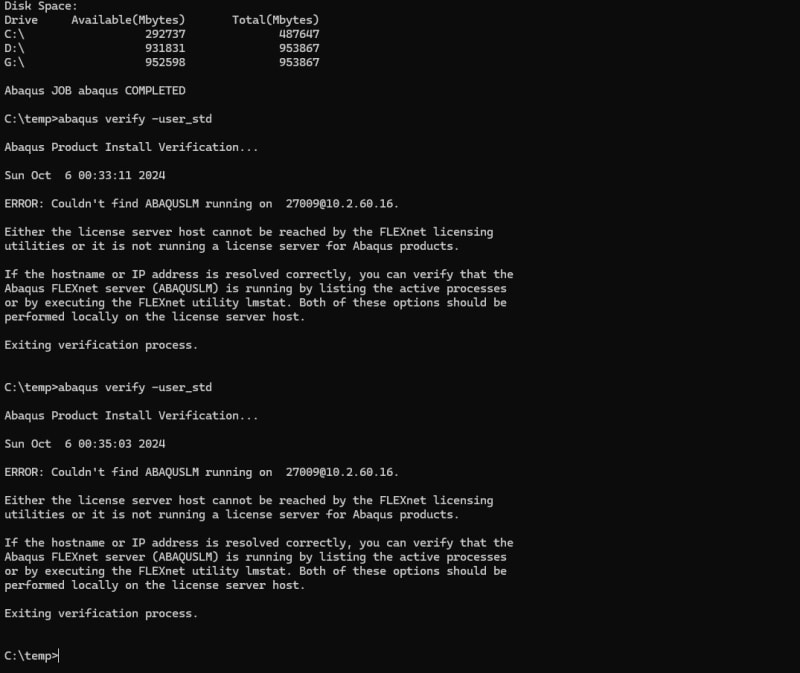

Dear helpers,
I am getting the following error, once i am running the UMAT subroutine file.
Problem during linking - Abaqus/Standard User Subroutines. This error may be due to a mismatch in the Abaqus user subroutine arguments. These arguments sometimes change from release to release, so user subroutines used with a previous release of Abaqus may need to be adjusted.
I am using the following
Abaqus 2017 6.20
Intel Fortran Compiler 2021.13
Visual Studio 2022
Did you try running subroutine verification procedure and some simple subroutines from the documentation to make sure Abaqus is properly set up with the compiler ?
Thanks for help. I have run the subroutine verification and it failed. i have atached the same file.
