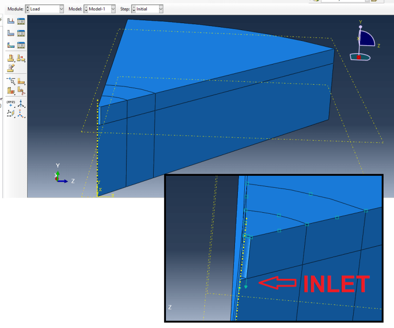

Yes, you were right. My analysis consists in two cylindrical models. This is the fluid model:
The model's material is water, there's a water inlet at the center of the model.

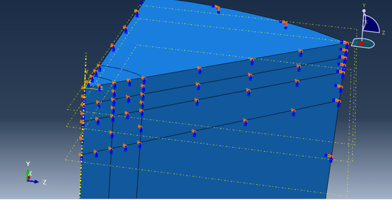

The soil's model is at the next picture, it isn't a assembly of the two models, it's the soil model alone.

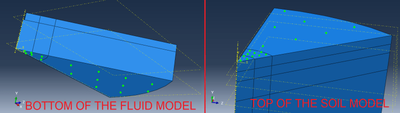

To co-simulate the two models, I'm using a Fluid-Structure Co-simulation Boundary, at the Interaction menu. Here's the surfaces of both models where ocurrs the interaction:
Is your approach on this topic based on some reference article ? Even if it seems to work properly I would suggest trying with SPH, as Erik said. Water jet eroding soil is hard to model using other methods than SPH. In your case there's a large fluid domain with very small inlet in the middle simulating narrow stream of water. This seems somewhat inefficient. Also it would be much better to include damage model and element deletion for solid domain.
