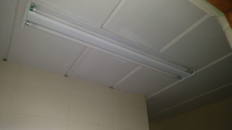

Hello,
My firm is conducting a review of buildings built in the 1950's near Toronto that utilize precast concrete roof slabs. These slabs are 18" wide and span roughly 20 feet. We have a bunch of literature corresponding to different products that these roofs were made of (eg. Siporex, Rapidex etc.). However, the pages we have for a 18" wide panel does not have a product name written on it and seem to be a different format from all other products that we know of. Does anyone recognize these pages and give direction as to what the product is called?
Here is a picture of what the panel looks like from below:
