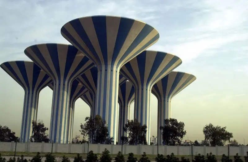

You can make some very attractive water towers...
Make it a tourist attraction and give tours and have a viewing gallery!
Probably make more money than distributing water....
[URL unfurl="true"]https://res.cloudinary.com/engineering-com/image/upload/v1718197719/tips/kuwait_water_towers_ddhlg6.webp[/url]
