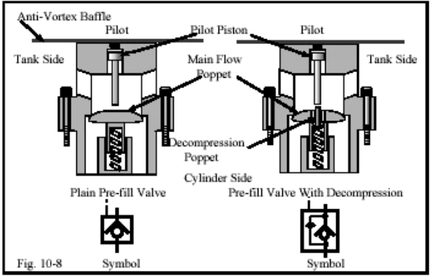

Hello All,
Just a quick question. I am learning about hydraulics these days. I have some doubts about the prefill valves. I understand how they work. I understand the hydraulic schema but can someone mark to me about the actual parts vs the symbol parts. Where is the magnet on the position mounted, where is poppet
The poppet spring(s) is/are not drawn in the symbol but could have been drawn to make the symbol more complete.
The pilot piston is not drawn in the symbol because it is of no extra function...
