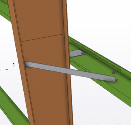

I am in the process of analyzing a pre-eng frame for a new loading case. I've calculated the column compressive resistance as per CSA S16 13.3.2 for flexural buckling, however in my case the web slenderness ratio forces me to use 13.3.5 and reduce my yield strength to Fye = 83MPa. I have the component/loading sheets for the existing pre-eng, and calculated the load on the columns based on the provided reactions, and the reaction well exceeds the resistance calculated using the effective yield strength. If I calculate it assuming no local buckling of the web, the column is nearly at 100%, which given how tight pre-eng usually gets designed doesn't surprise me.

Your results sound off to me. Are you considering the girts and flange braces as weak axis restraints for bending and compression?

Canadian code offers 2 methods. Either reducing Fy, or reducing effective area like you said. It wasn't until the most recent edition of the code where it actually specifies not to use the Fy method for anything other than circular shapes. Using the area method my capacity is much larger.
