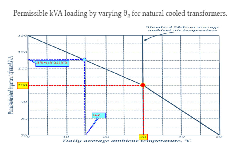

The following curve is an interpretation of the transformer power rating capacity derating/uprating factor depending upon the 24 Hr. average ambient temperature. It should be noticed that for short term rating there is directive in the standard for safely overload the transformer above the nominal nameplate rating of the unit.

Derating can also go the other way in cold temperature climates. A Generator Step Up Transformer connected to a gas turbine driven generator might operate 10% or more above its nominal rating in cold weather. The cooler, denser air also lets the turbine produce more MW. If that happens, the cables better be designed to carry the additional load. If they are underground cables the cooler air will not have much of an impact on cable rating.

IEE Standard on Transformers are based on a maximum ambient air temperature of 40C and a 24 hour average ambient temperature of 30C. A maximum oil temp rise & maximum average winding temperature rise of 65C and a max winding hot spot temperature rise of 80C are specified for these conditions. In case your ambient conditions are within above (40&30C ) no derating is required. It is assumed that any excess ageing occurring ( with 30C as reference) at 40C is compensated when unit is working at 20C or lower temperatures. But if at site, any of these (30& 40C) are exceeded, then oil and winding rises are to be reduced to the same extent ie rating has to reduced or cooler size to be increased.
