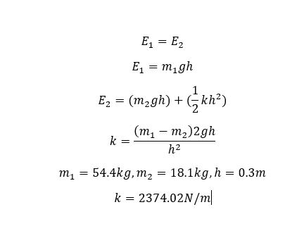

I have built permanent docks that utilize 4x4 treated posts driven into the lake bottom. Large pneumatic drivers work great but require an 80+ CFM compressor and a floating platform with a hoist of some sort to operate. On repairs. I have used a hand driver that is square metal tube with a cap and handles welded on. To automate this I added a Pneumatic cylinder to raise and lower this capped tube. It operates on a 5-6 CFM air compressor and works great.
Now the question: My goal is to drive a post with minimum blows while maintaining portability. I can add more mass, add springs or change pneumatic design. I understand how free falling mass and velocity affect impact. But, what makes my brain hurt is determining impact force when i add a pneumatic cylinder pushing downward at a specific PSI. Further brain strain is how adding a tension spring affects impact force (Given an extension spring constant (K), and a distance (d), how does this affect impact force of a falling mass)
What I can speculate is that either Air pressure or springs can increase velocity. I don't need exactness here, I just need to understand how I can better predict outcome and lessen trial and error time (of which I have invested a bunch).

Coming very late to this discussion, but here are my (very simplistic) 2 cents.
If the driver is essentially in free fall at the bottom of the stroke, the energy available to be transferred to the pile is entirely the result of the mass and final velocity of the driver. If increasing the mass is not an option, then increasing the velocity is a good approach. This final velocity is entirely dependent on the height it falls and the acceleration provided by any force(s) applied as it falls. Ergo, any method that increases the end velocity increases the energy available to perform the work of driving the pile. The end velocity is increased by acceleration, either from the force of gravity or the application of another force. Springs and hydraulics or pneumatics can add to the gravity force. Velocity is also increased by the time duration of the applied force (gravity, springs or pneumatics). This suggests that simply increasing the length of the tube above the pile may be worth considering.
If the device adds force to the driver as it impacts the pile, that force gets added to the available work. This would include springs that are not fully compressed or pneumatics that still have pressure at the bottom of the stroke.
I know it's not much but that's all I've got...

Your link is a miniature version of the type that Berkshire linked to. The "T-Post" driver that you linked to is about as big as I've ever used myself, and it's exhausting to do just a few tiny T-posts posts with one. You are holding the 40 pound machine by hand over your head. Now imagine a 4" post driver, lifting 100 lb over your head, let alone holding it there as it jumps and dances around.
IMO this has to be attached to the boat by an arm or a davit, and have a significant mass to be effective. Kinetic energy is 1/2 * M * V^2. You need lots of M and V!
The hammer of the "HeavyHitter" is a steel plate 4" thick and 12" square so it probably weighs 200 pounds alone, and the slider probably just as much. The stroke is longer, so there's about 100x more energy per blow. Providing a driving force on the downstroke doubles the acceleration, getting 2x more energy again.
