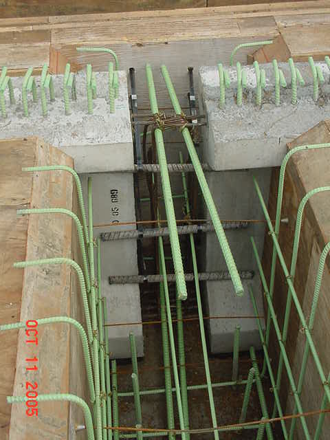

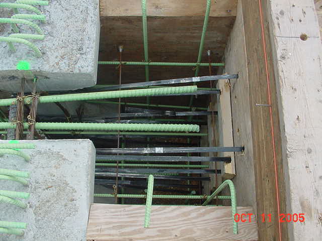

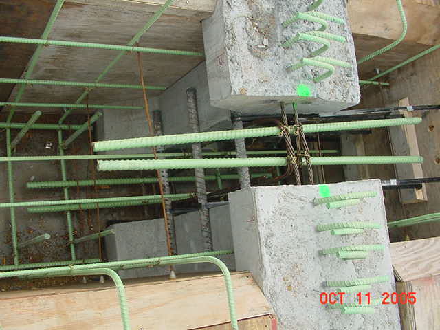

I will find some pictures of a bridge I was the inspector on when I was an EIT in Kansas. I have good pictures of the pier diaphragms formed up with all the steel tied. I don't remember there being that much steel in the pier diaphragms. Why are the pier diaphragms so congested?

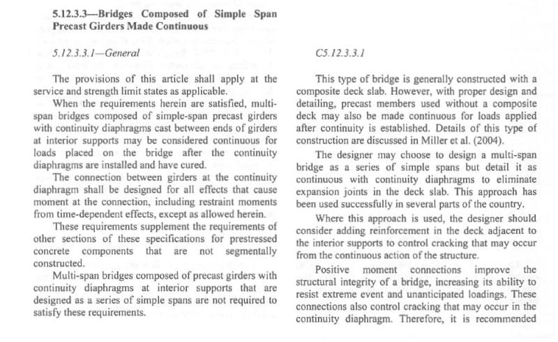

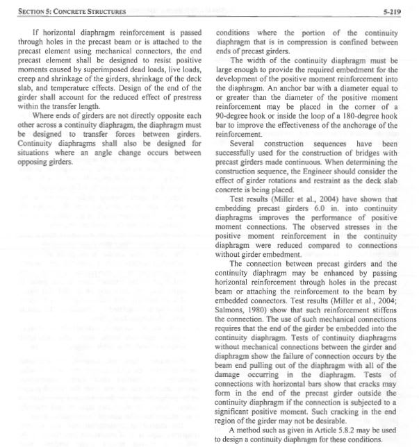

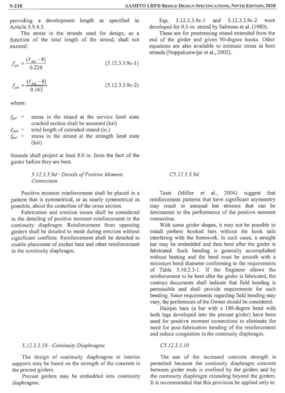

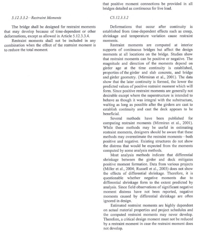

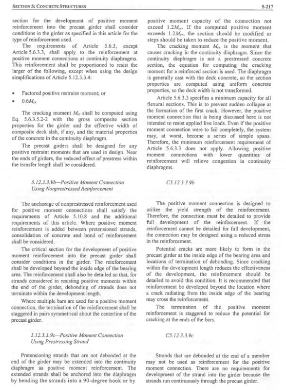

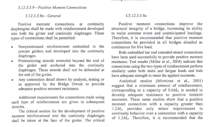

Thanks for the replies. Some background. This is indeed referencing the bridge response shown in AASHTO 5.12.3.3.9 above. This issue I was having is the moment generated at the supports due to differential creep and shrinkage between the beam and closure pour.
Turns out buried in the state's bridge standards, was a note to age the 90 days prior to pouring continuity diaphragms, this is what I was looking for- The difference between 28day and 90day in the creep and shrinkage calculations cuts the positive moment at the support by almost half.
