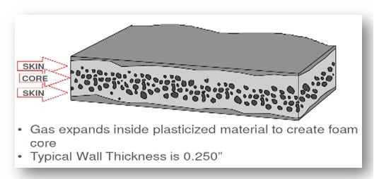

Has anyone information on how Pool Hose Floats are made and from what material? These are the C shaped floats that snap onto the suction hose and appear to be some sort of injection molding but are very low density. Attached is a picture of one. Despite being heavily foamed they have a good surface 'skin'.
Thanks in advance
Scotty
 https://files.engineering.com/getfile.aspx?folder=bd04aedb-2806-4715-8cba-9ae5cb1a7cce&file=hose_float.jpg
Unfortunately noodles are extruded where the floats are injection moulded, they will be similar materials but the trick I need to find is howw they have been processed.
They could be structural foam injection molded or reaction injection molded with a foam insert. The swirls on the surface are typically seen on structural foam parts which makes me lean that way.
