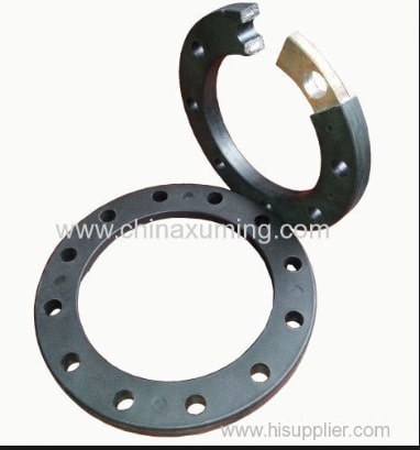

Hello,
My native language is spanish so, excuse my english.
I'm preparing Data Sheet for Polypropylene(PP) Flanges.Our Client have your products of vendor call SIMONA and I have a doubts about their brochure material description.
For blind and back-up Flanged theirs description of Material is: Polypropylene (PP) with glass-fibre reinforcement, steel insert
So my question: This flanged is steel lined with Polypropylene (PP) with glass-fibre reinforcement ? or "steel insert" means other thing ?
I attached SIMONA brochure in this thread, please see page number 182.
I need to solve this, because next tuesday (16) I have to deliver this data sheets.
Thanks in advance.
Regards all
 https://files.engineering.com/getfile.aspx?folder=20508aa5-6ec1-44dd-856d-113a86bc4805&file=15282_Bruttopreisliste_2018_PP_PPs_PVDF_ECTFE.pdf
Bit difficult to see from the brochure, but insert tends to mean that the a steel ring is somehow inserted into the PP with fibre re-inforcement.
My guess is that this would be the bearing surface between the flange ring and the metal bolts to prevent damage to the PP/GF material as the bolts are tightened.
If enlarged the backing ring flange picture in Page 182, you will see a "hatched" area (steel insert) with a coating layer outside (glass-fiber reinforcement) for corrosion protection.
See similar item from googling photo below:
Thanks LittleInch and mk3223 for your Help !!, I was confirmed by Vendor this afternoon that the steel insert have coating layer outside of glass-fiber reinforcement PP. [thumbsup2]
