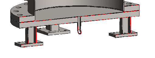

I'm working on a pressure vessel with a blind flange at its base, supported by a few large SHS's. To avoid FEA, can anyone direct me to a suitable hand-calc that could be used to assess the effect of the legs on the flange?
I'd been thinking of using Case 19 from Table 11.2 in Roarks 7th edition, to compare the deformation due to the reaction force from the legs to the magnitude of deformation from internal pressure, but despite it being for a fixed edge the results I'm getting have deformation at the perimeter - clearly something's not right there, and I'm struggling to find another resource.

To work with some round numbers, as I'm now away from the data:
[ul]
[li]DN600 PN6 Flange at the base of a vertical pressure vessel[/li]
[li]3barg applied internally[/li]
[li]4x 50x50x3mm SHS's (Square Hollow Sections - aka box section) equispaced on a 500mm PCD[/li]
[li]1000kg fabrication mass (acting as a line load at 600mm DIA)[/li]
[li]500kg fluid mass (acting as a UDL on the inside of the flange)[/li]
[/ul]
The critical point in this instance is the effect the legs have, as the integrity of the flange itself is verified easily by other means.
For information, this is the Roark's case that seemed to suit best (however deflection at the edges would suggest the formulae aren't right for the fixed edge case):

Image of the base of the vessel (I feel the need to point out that I'm being asked to verify by 3rd party, as there's 64mm of steel directly above the legs...)

Would it be feasible to make those legs into a circular skirt, so the blind flange can then be analyzed by circular-plate formulas from Roark?
@ Plungeman
For lugs supports Bednar is clear. The effect of lugs in the blind flange see "Support Lugs with Full Backing Rings" (by Bednar) for guidance and use appropriately.
NOTE: This design is not a good idea, avoid welding on blind flanges. PWHT or preheat may be required depending on material.
Regards
Problem is, if you apply ASME design rules to a standard flange the flange may fail even before adding the legs.
The legs are in line with the gasket face so are not putting bending loads into the flange (from gravity anyway). Could be OK. Compare the stress in the flange due to pressure and bolt up with the stress from compression in the legs. Bending in the legs from EQ could high.

You may attach 2 parallel plate stiffeners on to the blind flange for opposite legs, another two for other opposite legs. This may help providing stiffness against deflection under pressure in addition to creating support on blind flange for legs (you may weld support legs on to the stiffeners on each side). You may increase the number of the stiffeners in case you want uniform correction all around which may help correcting the uniform pressure on the sealing gasket. I hope my description clear, I cannot draw and attach a sketch at the moment.
In case the welding at around the centre of blind flange you may add a pipe which will have the same height of stiffeners. This may help for the access of the drain pipe. Just be careful with the nozzle access.
Of course you need to make some structural calculation on the stiffeners for the proper load path and stress distribution on them. Ultimately you may try FEA.
Beside all, I have to ask why you are using a blind flange instead of a head. Blind flange draining at centre will not warrant full drainage, and cause corrosion.

I am looking at your problem differently. You will have two types of deflection and stresses which can be superimposed for a final answer. One type of deflection will be caused by the internal pressure within the vessel and the second type of deflection will be caused by the weight of the vessel.
Imagine the vessel to lay on its side, you'll realize that the blind flange is uniformly supported at its edge by the bolt pattern and the deflection curve on the blind flange will be solely from the internal pressure in the vessel from which stresses can be determine.
As far as the weight on the vessel on the supporting legs you will have four opposite point loads on the blind flange from the legs. the load on the legs is due to the uniform load created by the vessel flange near the edge of the blind flange. Another deflection curve will develop from such reactions. The two deflection curves and resulting stresses can be additive.
Equations for deflection and the resulting stresses can be viewed in Kent Mechanical Engineering handbook "Design and Production" 12th edition pg 8-32 thru 8-35. The drawings and formulae presented by Kent is by permission from Formulae for stress and strains 2nd Ed., by R.J.Roak copyrighted 1943.
