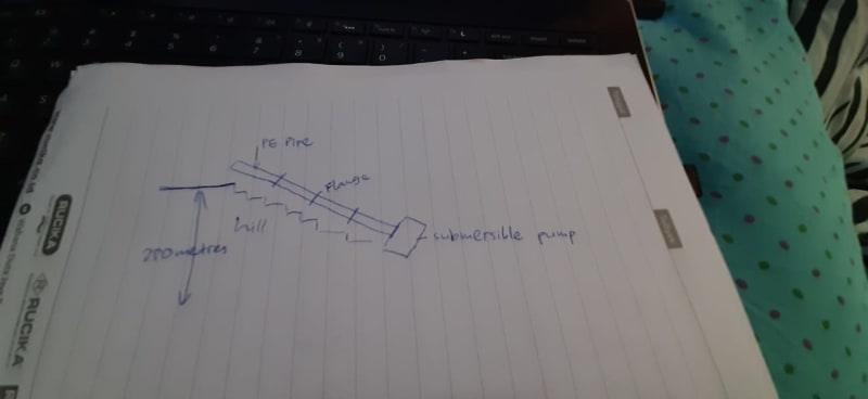

I have case for dewatering pipeline cost calculation, so now my existing customer had digging for 50metres pit with HDPE PN16 with 315mm OD (SDR11) and have plan to get 200metres more depth, they ask me about : was the pipe still strong enough to go through 250metres (with 6m each flange connection) or have to order pipe with higher/thicker pipe (PN20), I have to convince them to use the PN16 because with PN20 the price will be like twice higher (of course with a 'make sense' calculation)
250 metres deep???
A plan / section or drawing might help us understand what your issue is.
PE pipe you usually fuse together not flange.
I just don't understand your question.
so 250metres depth of a mine, also why we use flange because after finish dewatering we dismantle the pipe and move to other 'hole'

SO for 250m ( that must be one hell of "hole" - any pictures?) you really need something more than PN20 at the bottom as this is only good for 20 bar / 200m. In reality PN16 pipe may not burst at that dpeth but it won't last very long and could break ( usually a fish mouth type split in the pipe) I wouldn't recomend PN 16 below 200m
This all assumes that once the water gets tot he top it just exits out of the pipe and flows away. If it flows some distance away your pressures all increase
