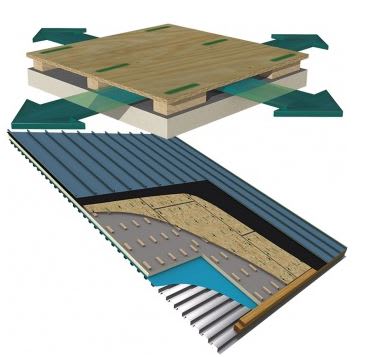

I am vetting the use of a 'non structural' ventilated roof panel. It is supported by a metal roof deck, but the panel itself is polyiso insulation, 2" air space, and 3/4" plywood. The airspace has 2"x6" blocking spaced at 18" O.C. one direction and 12" O.C. in the other direction, forcing the plywood to act as a two way plate.
I have significant snow loads on my roof - up to 200 PSF in drift zones - and the manufacturer does not have engineering / load data for capacity available. Does anyone have experience analyzing plywood for two way action?

The plywood is supported on the intermittent blocking, which is supported on polyiso insulation, which is supported by 3" metal deck as noted in the OP. See below:
a picture is worth a thousand words, you're definitely into two way plate area in a configuration like that. I would probably still be breaking it down into two components. My first kick at the can would be to have the plywood span up and down the roof to the lines of blocking, then I would check the plywood spanning between the blocking for the increased load. i.e. if up and down the roof the blocking has 16" spaces between pieces, then I would analyze the plywood for 16" span. Then left and right I would check a piece the width of the blocking, for a load equivalent to the blocking with plus one gap.
