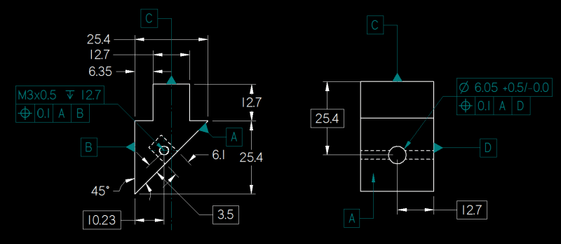

Hi all,
I am a novice with regards to the proper application of GD & T.
I have attached a drawing of a simple part I have added it to- where previouly it was dimensioned without it.
Can you give me some feedback with regards to the application of the symbols I have used.
I am working to ASME Y14.5 and in units are inches.

So, I have reviewed my datums with a view to the functionality of the part bearing in mind the outside profile sits in mid air with no functionality at all.
I think this looks more sensible for what I need.
Thoughts?

sammcc,
On your latest edit in regards to your datums themselves it looks like nothing was changed, besides removing any form/orientation controls which are critical for datum definition (not sure why you removed those? they are now held to your relatively loose all around .020 profile tolerance except for A which is uncontrolled).
Two of your datum features B and C are contained in that profile. Are these (or datum feature A as well) actually functional or mating surfaces, or are they as you say "with no functionality at all"? Datum selection should always be driven from part function first - your three planar features are "nice" surfaces but if they don't reflect how the part functions or assembles then they are arbitrary.

Datum surfaces B and C are not functional or mating in any way.
Datum surface A is the mating face, it is where this block attaches onto another smaller block.
The contact area is minimal but I do think I will add the flatness tolerance back into datum surface A
sammcc, it doesn't matter if they are functional, you should try building the model to see what your callouts currently accept, because you have said to mate d/f B and d/f C with the inspection equipment and possibly are leading the machinist to to do the same when he creates the holes that reference them as a primary datum reference.

3DDave - you aren't suggesting what you seem to be, are you? Would you disagree that datum selection should be driven primarily by functional intent? In this case I might agree that there may not be many features precise enough (drilled/tapped holes) besides the surfaces selected and therefore might require an alternate set of datum features - however since these are non-functional surfaces OP has changed in his latest revision from a perpendicularity tolerance (and flatness on the primary) of .005 to profile of .020, a 4x increase in tolerance zone size which will directly affect the accuracy of any features held to these surfaces.

sammcc - you have a datum feature controlled by the size tolerance on the thickness of the part (1.000) which is held to print tolerances. I don't know what that print tolerance is but it is likely looser than one would typically want for a datum feature. If that is acceptable then I guess I'll see myself out, but I would recommend as 3DDave suggested that you build your model and perform your stacks to ensure the variation is acceptable - from your first revision to your latest there has been a large jump in the allowable tolerances your datum features are held to.

So, the general limits on 1.00" dimension is +/-.010
I have drawn a quick sketch to show the functionality of the part.
It is part of a test fixture and is mounted to a base plate via a mounting block so part of face A is the only face that comes into contact with anything.
