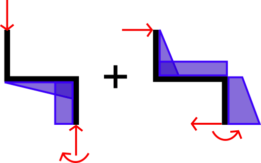

Hello,
Can anyone please guide me on how to design the plate for the uniform moment shown in the attached sketch? I am following AISC for the design. It seems very simple design but I am getting a bit confused and wanted to be sure. Thank You for the help.

Plate's the easy part... use plastic moment modulus Z = t*d^2/4 (S for Aussies) and Mr = phi * Z * fy. The connections at the end with bolts may be a little trickier and the stability of the plate/connection may be an issue.

Conceptually, isn't what you are trying to do the same as an extended single plate shear connection?
Are you actually trying to pass a moment from the top HSS section down to the lower one, or; are the top+bottom HSS connections a pinned; and you just have a moment in your connecting element?

Yup... That's what I think... maybe really extended, and there could be other stability issues.
The moment in the plate is not uniform since the eccentricity from the vertical load changes along its length. Split up the applied loads and look at the moment diagram for each of them.
Your applied loads also produce moments in opposite directions. Is the horizontal load always to the right? Are there any load cases where one of the loads is not being applied? If so, then those load cases would control.

Thank you all for the inputs. I should have mentioned the backstory. This connection is to support a curtain wall. This support would be on both ends of the curtain wall and I believe this would help make this connection stable. Is there any other concern you see? I am going to weld the bottom of the right HSS in this connection to a beam that is below it. The top of the left HSS in this connection is free.
Is there a vertical load to be carried through the joint or is it just a flexural member carrying horizontal wind load from the curtainwall?
Must of the responses are geared toward some vertical component, like the thing is a hanger of sorts.
There is a very small dead load going thru the joints, as small as 1 kip.
See F11 in AISC for rectangular bars- may not apply if it's short enough.
