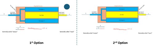

Hello,
I am trying to understand why the planetary gearbox manufacturer recommends mounting his planetary gearbox through the High Torque (Low Speed) side.
I tried to figure out what is the reason, but unfortunately he didn't reply.
A colleague told me I would better mount the gearbox through the High Torque (Low Speed) side, because otherwise "I will transfer all of the generated forces through the gearbox housing", and I am not sure I understood what he meant.

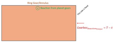

I tried to use a simplified FBD (Force Body Diagram) to analyze the reactions on the gearbox housing in both optional mounting cases (through the High or Low torque side), and it seems that in both cases the gearbox housing reaction would be the same – tangential friction forces (under the bolts' heads) that resist the same torque, no matter to which side it's connected.
Am I missing something?
Thanks!
OP

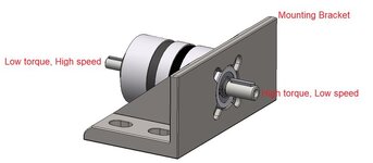

I am trying to understand to which side of the gearbox I attach the L bracket, and if it matters in terms of gearbox durability.
I need to increase the speed.
So my manual handle (input) is connected to low speed (high torque) shaft. The output is the shaft on the side of high speed (low torque).
Now - I have interface to mounting bracket connection on both side of the gear (input and output sides) and I wonder if the side the L bracket is connected to matters? And how?

I'm just making a quick comment based on the first post. You get a reaction at the mounting points because the housing is trying to turn in the opposite direction of the output torque. If you mount the gearbox on the output side as shown, the reaction acts as a tangential shear load on the fasteners right at the face of the gearbox. If you mount on the other side, the input side, the reaction is still there but it has to travel as a torsional load on the body of the gearbox to get to the face on the input side. A bigger consideration is whether you have an overhung load on the output shaft. Is it connected to another shaft or is it turning a pulley, sprocket or gear? If so, I would definitely try to mount to the output face.
Misalignment at the high speed side will experience many more cycles on the shaft coupling, high-speed shaft, bearings, and seals than the low-speed side. I would strive to provide the best alignment capability at the high speed, low torque end. The housing reaction does not seem that important to me - if the mounting screws can handle the reaction, then surely the housing is capable.
