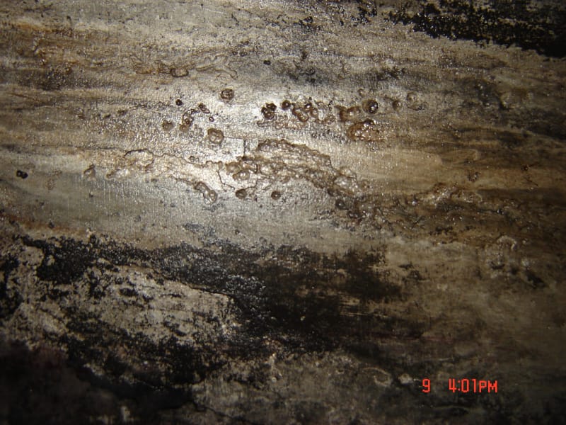

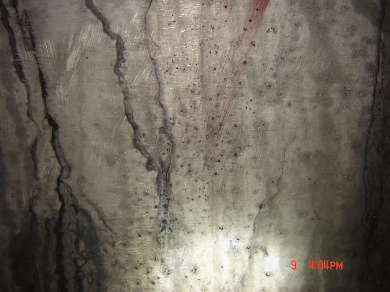

A reaction vessel made of SS 316L is subjected to pitting corrosion after 1 year in use. Can anyone help to analyze why the pitting corrosion occurs? Thanks!
Acylation tank: SS 316L
Media: 25% acetic acid, datril, other impurities.
Highest working temp,: 130°C
Please see the pits on internal surface: oh sorry. I can't paste the pic directly to the post
One of our senior engineer says that it probably be caused by the halogen contaminants (especially chlorine ion from potable water).

Dear Larry-MTS,
Did you find the pits only on the bottom plates? If yes, then can't agree more with your engineer.
Regards.
DHURJATI SEN
The grooves are interesting,is that a vertical surface?
In low pH 316 will not handle much Cl.
The curves that I have show pitting at T=130F pH=4 and <10ppm Cl.
