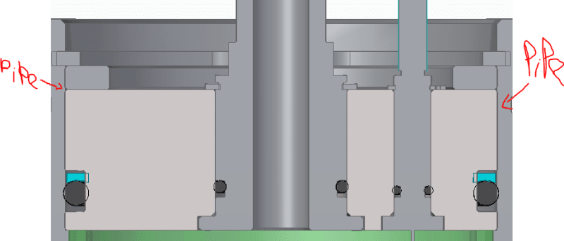

I'm trying to seal a plastic pipe that works in High pressure (50 bar).
I done want to machine the pipe are there any shelf items or ideas that you think might work.

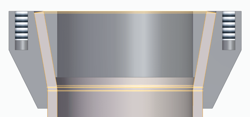

I attached 2 concepts I was working on.

I think your concept needs more explicit information. I don't understand the drawings. Is it glued in? Friction? Thermoelectric?

Really? Care to share the data sheet??, but I agree with Mr 44, It isn't easy to understand what is sealing with what in that drawing. Or what you're using? Bolts, glue? external clamp?

Regarding Dash 44's reinforced composite pipe, you really would need to discuss the end fitting design with the manufacturer; those things aren't just banged together with compression fittings, nor would they hold up if you cut a retaining ring groove on the i.d. (that being my interpretation of your sketches).
in the first pic you can see the the current design we're using.
it has a groove for a retaining ring and it holds at 50 bar. I also peformed a shear stress calculation with 50 bar there in no problem.
now we got different pipes the problem they are not straighte we nee to straighten them and seal them,and they are not very circular.
I couldn't find a relevant end fitting for them so I thought maybe I ask here.
and I also added a concept for the design. that I machine a conical peek insert it with force (still didn't add groove+o-ring) and close everything with a lid)

I will suggest you to use external insert with back-up flange.
