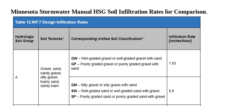

Does anyone have a table of washed stone infiltration rates?
I designed a pervious driveway for a customer which was basically 4 inches of surge stone over geotextile fabric topped with 1 inch of #67 stone . Apparently, the new state standard in our area is 4 inches of #57 stone alone (they used to allow any washed stone above .08 inches in diameter. That was changed without me knowing about it). They want me to prove that my design meets or exceeds the state standard. Intuitively, I don’t see how it can’t and also it has to be better than pervious concrete that is also allowed.
Yea, yea, I know it ain't a great path to drive on but the customer is actually happy that they didn't have to spend tens of thousands on pervious concrete.
Thanks!

Looks like they feel any washed stone has similar drainage characteristics..

is it really infiltration rate that you need to prove? or is it the retention volume? pretty much all gravel or crushed will have relatively high infiltration rates.
your chart above does not apply to washed or crushed rock, it applies to unwashed mixtures of gravel and sands which probably have lower infiltration rates than any sort of crushed rock.

The infiltration. The whole thing is a pretty dumb exercise if you ask me.

If this has already been constructed (which it must be otherwise why not just change the stone requirement in the design) I would suggest you do an infiltration test on site. There are numerous methods, but i would suggest using a cylinder that is not too big, infiltration will be to ground so cylinder will need to "seal" against the base filter fabric and measure the rate of water depth drop mm/hr (inches/hour glass) and keep topping it up until your drop rate becomes constant. This would be your base soakage rate which you would probably factor by 0.25 based on the fact that it is very likely to silt up over time
I thought about that. I'm gonna try arguing logic first.
