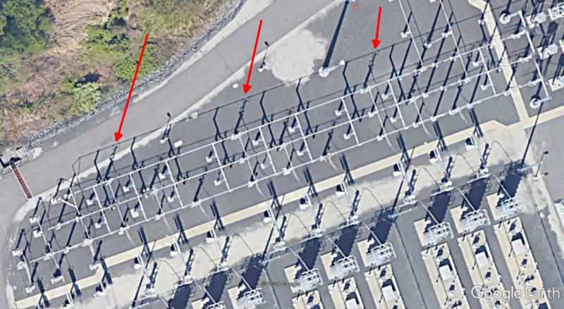

The picture below indicates that there are standard AC switches mounted in a 4 leg pedestal. Pantograph disconnect switches were not observed.

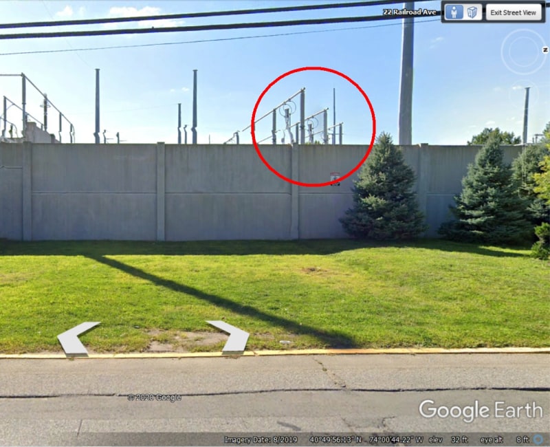

I'm probably thinking of the wrong converter station. 1 Railroad Avenue Ridgefield New Jersey.
Google street view and Google aerial shadows appear to show pantographs and and live tank breakers. Here are two examples:
