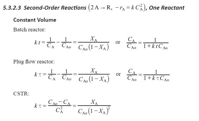

Regarding the 2nd question, I do have the PE reference manual and this should be the formula for the 2nd order CSTR reactor. What confuses me is the mean residence time. Is it based on a certain conversion ? The question has already stated a space time of 2200 sec at the conversion of 65%. My understanding is space time is mean residence time by definition.

This is a CSTR, not a plug flow reactor. Conversion at all points in the reactor is 65%.
OP, 0.65 mols of CH3CHO are converted, producing 1.3 mol of products. There are 0.35 mols remaining unconverted, for a total of 1.65 mols out. Vout = Vin * 1.65.
Again, one of the fundamental assumptions for a CSTR is that it is well mixed and the composition of the reactor is uniform. This means the outlet conditions are the same as reactor conditions, and that the mean residence time is calculated using Vout.
This isn’t quite correct, as composition gradients do exist in reactors, but for especially slow CSTRs with large spacetimes, it’s not a terrible assumption.
The PE exam only deals with the well-mixed assumption; otherwise all the given equations are not correct.

@TiCl4,
Oh. Now I got it. Forgot to consider the unreacted CH3CHO in the outlet. It makes total sense that the mean residence time for CSTR should be calculated based on Vout. For PFR, I guess the mean residence time should be somewhere between the numbers calculated based on Vin and Vout.
