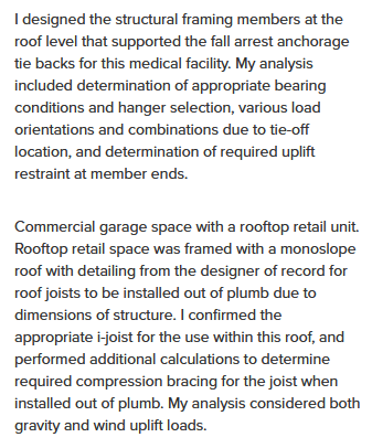

Hi all,
I struggle with mental blocks when it comes to writing, especially when writing about myself. Would anyone be willing to share their work experience that they submitted with their PE license application so that I could use it as a template? I just need something I can plug my experience into without having to type out all of the "extra" filler language. My experience is mostly in high seismic, both residential and low-rise commercial buildings.

This is for your Oregon PE application, as you've stated in your other thread, correct? I had my NCEES record up for archiving continuing ed., so I'll grab a snapshot of a couple of the notes I included in my application to Oregon, see image below. These (2) examples are for separate structures. Since these were accepted as part of my application to Oregon without correction, I would expect that you recording the work that you have performed in a similar matter to what is written below would be sufficient for your application.

Thank you, that is very helpful. Yes, I am applying in Oregon. I have heard that the board is not super strict here, but they also give little to no instruction on how to describe our experience.

Looking back, this was the general format of mine. Basically a brief description is provided of my involvement in the project including basic materials used, design challenges, etc. Some of the information might not be applicable to Oregon, I'm not sure. Some of this stuff seemed silly at the time, but just make yourself jump through the hoops and get it done.
