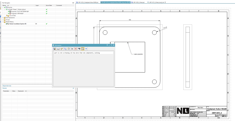

Cowski,
This journal works perfectly when working with stand alone parts. I've used it alot.
The journal does not seem to work for master model drafts with flat patten.
Lars
Lars
NX12.0.1.7 native
Solid Edge ST10
Inventor

@Cowski,
When I have a master model draft which contains views of a part and the flat patten view. I get the following
What can I do about it?
Lars

That's to be expected, it falls under the 3rd bullet point in my previous post. The code was written to export the flat pattern from the component of the drawing file. If you want it to process a larger assembly, you'll need to add code to process each component and export the flat pattern from each (assuming you want to export all the flat patterns and not just certain ones).
www.nxjournaling.com

Does the addition of a flat pattern view always result in a second reference component?
I'm trying to make an automated export from a draft resulting in a PDF of the draft and a DXF of the flat pattern.

Yes, it seems the flat pattern view also creates a "drafting component", which will need to be accounted for. I'll look into a fix as I have time.

Cowski,
It works pretty good. I have a few small bugs.
Attached I file which gives an error. I've attached journal also.
Is it possible to be making a DXF out of a mm draft and making a DXF out of a stand alone draft with the same journal ?
Kind Regards,
Lars
Lars
NX12.0.1.7 native
Solid Edge ST10
Inventor
 https://files.engineering.com/getfile.aspx?folder=a62ec614-f22c-4851-ab3b-e17aed6e4704&file=TEMP.zip
Oops, looks like I misplaced one of the function calls.
Try changing this:
Code:
If Not LoadComponent(realComponents.Item(0)) Then
    'component not fully loaded, will not be able to access flat pattern feature info
    lw.WriteLine("could not fully load component, exiting")
    Exit Sub
End If
myFlatPattern = GetFlatPattern(realComponents.Item(0).Prototype.OwningPart)
to this:
Code:
    Exit Sub
Else
End If
