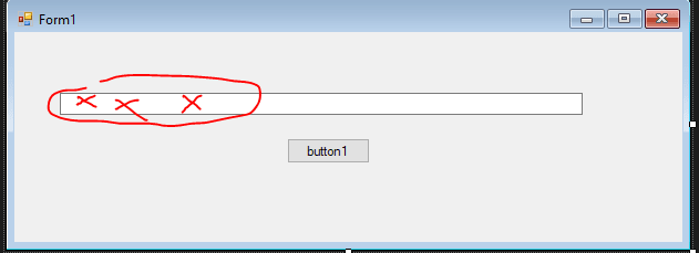

Hello all!
I want to write save the file program.
I have a question. For example there is a form with a textbox and a button.
In CATIA in the macro I call .exe file with the form.
How to get the value of a variable from form in a CATIA macro and pass it?
Here I'm call .exe file with GUI in CATIA:
form="c:\test\main.exe"
Here I'm want to save file with new name:
cad.SaveAs(dlname & "\" & PartNumber & doctype)
In the screenshot i'm want to get a path from folderbrowserdialog to a variable or textbox. Than i'm want to get value of this variable in CATIA macro and than put to SaveAs(*).
Is it possible - get value of the variable from exe form to CATIA macro?
It's doable, but most likely doesn't worth it.
Why do you use .NET in the first place? What's your goal?
I have no idea how to save with the choice of file name and directory differently.
Also I haven't seen directory selection methods in CATIA macro.
It can be achieved with standard COM objects
Google "vbscript select folder dialog".
