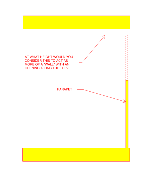

What would one use for a parapet wind pressure on a low roof adjacent to a tall building? Calculating this load per ASCE7-10 would you take h as 250' or 50' (specifically for the parapet design in question)?
Would your answer change in any way if the low roof height was closer to the upper roof, say 230'?
Also, at what point would one consider a parapet to become more of a wall with openings along the top as opposed to a parapet assuming there is roof above, as in the below sketch? At some point, the wall would enclose the space such that you no longer have exterior pressures on the back side. I would think that there is a point where the space inside of the wall becomes partially enclosed, then fully enclosed as the top of the parapet gets closer to the roof above.
I guess the more specific question is at what point would it transition from a "partially enclosed" condition to a "parapet"? Is a 1' gap considered partially enclosed, but 2' or more you would treat it as a parapet?
Thanks in advance.
I would take h as 50'. I would use the actual h value for the roof in question. So if it's at 248.9 feet, I'd use that.
For your second question, it depends a lot on what's around. How is there a roof there? Are you looking a glass guardrail setup on a balcony with another balcony above? If so, I wouldn't consider that a parapet as there's nowhere for the air to flow on the backside, and as such no suction pressure to develop. Wind design is a fluid flow problem. What is the fluid (the air) doing as it flows past the building? Parapets receive the loads they do because 1) there's a pressure acting against the surface and 2) they cause the flow to separate as the air goes by creating turbulent eddies that create a vacuum on the backside. If there's a wall there just a few feet away, you develop a back pressure that prevents that suction. If you don't, and you've somehow invented skyhooks to suspend this roof, then leave wind design to the peasants and go enjoy your billions of dollars.
Kidding aside, what scenario is creating this? I'd be inclined to say that I would do parapet as long as the parapet is half of the space between roofs or less. More than that and it starts getting a little gray. I'd try to stick with parapet loading as long as it doesn't make for an unreasonable connection or member size. If it does, I'd start looking for a way to rationally reduce the load.
Thanks for the input. To be more clear about the design issue, it is an enclosure of an existing roof-top deck. I say rooftop, but it's actually the level below the roof, so there is a slab above that covers the entire area and is supported on columns at the perimeter. Just typing it out has brought up another question: is the floor for this level technically even a roof surface, because the actual roof of the structure is one level above? While it might be exposed to some wind uplift, it's probably not nearly as much as the level above which is the actual roof, so in the case of leeward wall pressure + roof uplift pressure, I think there's a reduction there.
For the windward wall + leeward wall condition, I agree with you that if there is a sheltering wall or building just a few feet back (as in the case of a balcony) you couldn't necessarily see the windward pressure on the backside of the parapet.
While this all passes the test of reasonable engineering judgment, I wouldn't know how to justify that the code supports these reductions. The main crux of the issues seems to be how 'h' is defined as the building height, not the height of a portion of the building, and the fact that section 30.1.4 prohibits taking any reductions for apparent shielding. To further confuse the matter, figure 30.4-3 seems to imply that if the step between the upper and lower roof is significant, you would use the lower roof height (h2) to determine the lower roof pressures. Perhaps the newest edition of ASCE7 clarifies conditions like this.

1. My tired brain suggests that I would bracket the solution. Design the parapet for a 50' height assuming no adjacent building as a starting point. Then, assume that there is complete shading on the far side. Assess the difference. Then start to mingle with the actual leeward pressure on 250'.
2. I suspect that the H/d ratio of the building also plays a roll. If you can use a triangular loading, you may get a more accurate result.
3. NBCC 2015 deals with stepped roofs (Fig. 4.1.7.6D) that may be of assistance.
4. Save for a scale wind tunnel design, I suspect the lack of shielding provisions in the code is a consequence of wind loads (fluid flow) being relatively difficult to generalize and predict.
5. For the second exercise, I believe there is a way to calculate the gust factor based on the area of your opening. So, use the gap as a continuous opening and relate it to the code provisions.
