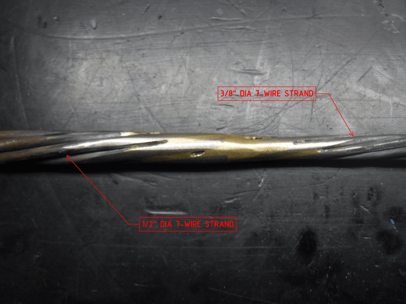

I have to butt-join two different diameter 7-wire high-tensile steel strands (270 ksi tensile) to each other. The smaller diameter strand - 3/8" dia - is a 'fishing' strand to assist installing the larger - 1/2" dia - to be installed into a 1/2" dia greased-and-sheathed HDPE conduit embedded in concrete (aka: repair of unbonded post-tensioning tendons).
I have done this many times - works well about 95% of the time - with the 5% failure typically due to me rushing on the prep of the strand and not getting good bond. There are no life-safety issues with this short-term temporary application, but it is a pain to have to fish out the strands and re-do the braze, and start the install application again.
I have a project with multiple 300 foot long strands to be repaired and 'kinda-don't-want-to' have the braze joint fail part way into the install.
What I do is un-ravel the outer wires of the 1/2" strand to expose the king (center) wire, and cut it back about 2" from the outer wires. On the 3/8" strand I un-ravel the outer wires and cut them back 2" from the king wire. Acetone clean all wires, then insert the 3/8" male king wire into the 1/2" king wire female, butt-end all the outer wires, then braze the joint. See following graphic:
I figure maybe I can get 50 ksi tensile capacity from a good braze, and if only assuming butt-joint capacity of the outer wires of the 3/8" strand I can maybe 4 kips of tensile capacity.
Is there a better way to make this joint stronger to reduce my 5% failure rate?
Worth much additional capacity in increasing the male-female insert length greater than 2"? The interstice space of the two varying diameter king wires may not be ideal for brazing - I am not really sure.
I may well do a few sample brazing tests and load test them in a center-hole ram to see how they compare.

If I understand the joint correctly, I don't think the king wires butting together count for much.
I think the 2" over overlap is way more effective, especially if I was able to clamp the very ends of the hollow outer wires to the naked king, and twist the fishing strand so the outer wires cling tight to the extended king wire before finish brazing.
Clamps -
Twist to tighten-
In fact I'd choose to extend whichever king had the most unruly or stiff outer wires, unless that combo is more likely to create a brazed joint with wires oriented to more easily snag during the pulling process. .
What brazing rod do you use ?
Is it flux coated ?
I'd be tempted to tin the naked king before assembling the joint, clamp and twist, and use a liquid flux to creep into the tightly wound bunch of outer wires before brazing.

The strand wires have significant stiffness with a defined 'lay' such that it does not require clamps to re-secure the strand pattern. Easily un-raveled and re-raveled without destroying or deforming the lay pattern.
I did a trial braze and cleaned up the joint:

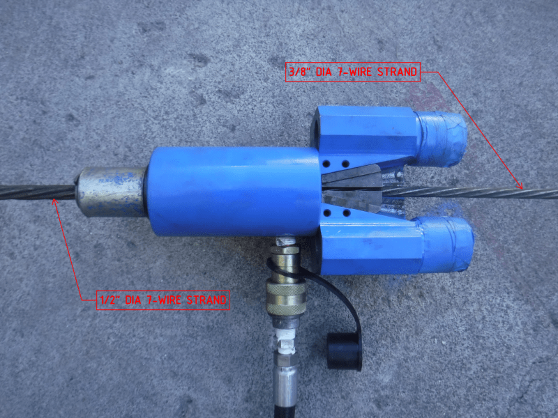

Did a quick tensile test with a 10 ton center-hole ram:

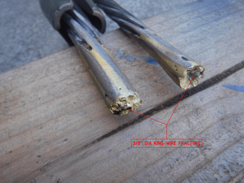

As expected, failure occurred through the braze joint where the outer-wires butt, and interestingly the king-wire of the 3/8" strand fractured, so effectively the 2" king-wire over-lap onto the 1/2" strand resulted in sufficient strength to result in fracture of the king-wire.
The failure load was approximately 4.5 kips. There was a small inclusion in the braze, but probably not significant in the capacity.
Ultimate tensile strength of the 3/8" strand is about 23 kips.
The capacity of the splice has to greater than the accumulated friction resistance over the pull length. I can work with a splice capacity of about 4 kips or less - I think!
So I am going to use 2" king-wire overlap and see how is goes in the field.

Compositepro, interestingly, last night, (before I saw your post) I actually brazed the larger king-wire from the 1/2" strand into the 3/8" dia strand and tested it this morning and achieved a tensile capacity of approx 10,000 lb.f. - about 2x more than I need.
The capacity of the larger dia king wire in only about 6.5 kips for 1/2" dia strands - so the braze of the butt-jointed outer wires provided about a 50% additional capacity across the joints failure plane.
With varying diameter strands the 'lay' of the strand outer wires differ by more than 2" over approx 6", so makes staggered-laps of the outer wires tough, and also some strands are RHS lay, and others are LHS lay. Addiitonally, the braze is done in the field, in exterior conditions, often at elevation, so the easier the joint connection, the better. However, I agree, a superior and stronger splice would be achieved via staggered-laps of the outer wires. Thanks for the idea.
With 10 kips splice capacity I am good to go.
