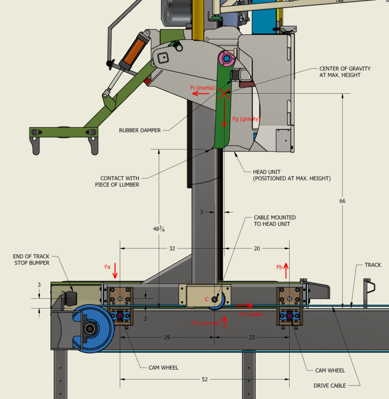

I have a machine which rides on 2 tracks, 2 track rollers per side, and is driven by cables which pull it back and forth. The sketch would be a side view of the machine.
I would like to calculate the overturning forces involved or the reaction forces R1 and R2 for 2 scenarios, to make sure the track can withstand the R1, R2 reaction forces.

1. For the first scenario I'm figuring for the direction of movement as shown, since R2 would be higher than R1 in this case.
I would have a gravity resisting moment of Mr = 6.5k x 66in = 429 k*in
The kinetic energy of the machine is: Ke = 1/2 x 6.5k x (8.3ft/s)^2 = 223.9 k*(ft/s)^2
Stopping force: F = Ke/stopping distance = 223.9 / 3 = 74.63 k
Moment of Inertia: Mi = 74.63k x 66in = 4925 k*in
Total Moment: Mt = Mi-Mr = 4496 k*in
R2: Mt / 20in = 224.8 k
R2 per cam wheel: 224.8 k / 2 (sides) = 112.4 k (per cam wheel)
This seems high and I would appreciate any input on my simple calcs.
2. For the second scenario I confess I'm not sure which direction to take. Some of the impact force is taken by the dampers, but the impact basically sends the machine in the opposite direction.
Any help is greatly appreciated!

I think our calc is ok, but the unit is trying to move around the front wheel axis.
So the moment from the weight isn't x 66, it's times 32.
Also your stopping force is adding to the overturning moment as it is not in line with the front axle so you need to add on 74.36K x 3inches

scenario 2 is an impact problem ... and the problem with impacts is always "what time duration of impact (or deceleration) ?"
whilst the body will have a deceleration at the CG (66") there will also be the force applied by the obstruction (at 36")
I think you have a mistake in your KE ... m is mass (not weight) ... mass = Wt/g = 6500/32.17
why Mr in "total moment" ? What you should be saying is that the weigh 6500 lbs is distributed over the 4 rollers, 20/52 on the front pair, and 32/52 on the rear.
your vehicle is stopping from 8.3 ft/s in 0.7s ... or 8.3/.7 = 12 ft/sec2 or about 1/3g
load on front rollers is 6500/3*66/52 = 2750 lbs
load on each roller is about 2750/2 +6500*20/52/2 = 1375 +1250 = 2625 lbs (1.2 tons)
Maybe - when i do this in SI units I get about 2,700lb force as the force required, which isn't far away from dividing your 74k lbf by 32.
Still need to figure out the moment arm though. I think it still revolves around the front axle.

For whatever it's worth here is another diagram, a side view snatched from the drawing of the machine itself.
So the point of interest is the force Fb (basically to verify integrity of track and CAM wheel structure) and I keep working at it.
For case 1, I think I need to reference the sum of moments around point C, since that's where the braking is happening.
As a note on case 2, I was considering contact with piece of lumber at 36in but I really should go at the maximum height of aprox. 49in.
